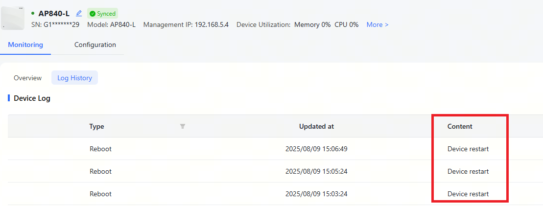

Device frequently experiences unexpected reboot

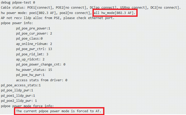

(1) When a PoE device only supports AF power (802.3at Type 1), some APs cannot achieve full performance. For example:
AP840-L under AF power only provides  single spatial stream service.
If “force at” is configured to enforce AT/BT power for multi-stream service,  insufficient power may cause abnormal AP reboots .

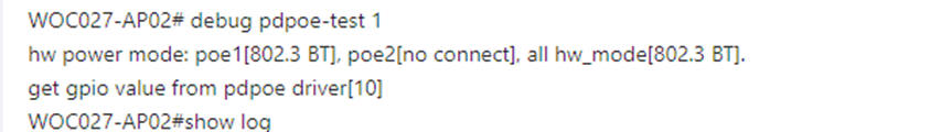

Note:  PoE injectors like RG-POE-AT30 defaults to AF power for AP840-L. Use force at command
  to switch to AT power. Verify protocol via:*

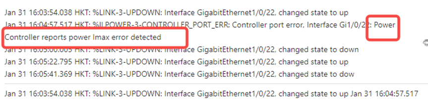

2. Vendor interoperability issues (e.g., Cisco PoE switches):
If AP negotiates AT/BT but switch provides AF, insufficient power causes reboots.
  *Known case: AP negotiated BT, Cisco supplied AF → AP rebooted.*
  *Switch power alarm:*
  Solution:
* Solution 1 (for AF mode) : Configure Cisco to auto, AP to force af.
* Solution 2 (for AT mode) : Configure Cisco to static (30W), AP to force at 25.
