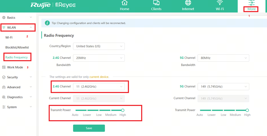

2.Check the signal strength(RSCP/RSSI) of the connected client
The signal strength can also be checked on a client device if you have Ruijie Reyee APP install on your mobile phone. When conducting the speed test, it is best to sure the testing device has signal strength above -65dbm.
If the signal strenghth is less than -75 dbm, heck if the RF power is set to maximum and try switching the radio to another channel. For 2.4 Ghz, you can choose from channel 1, 6, 11. For 5 Ghz, you can choose from any of the available channels.
