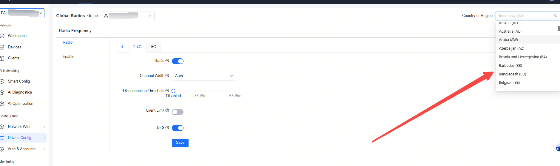

Hi Ruijie
Every time I check AI-based Diagnostics, it always says Capacity and Interference (Internet freezes)
I use 5G for 50 PCs connected to Wi-Fi.
Currently my WiFi internet is unstable..
How do I solve this?
Do I need to show another screenshot? In which menu?
thanks
RG-RAP2260(G)
Troubleshooting Wireless
0 2025-12-21 12:09:38 View all replies
Hello.
Have you chosen the correct country code?
