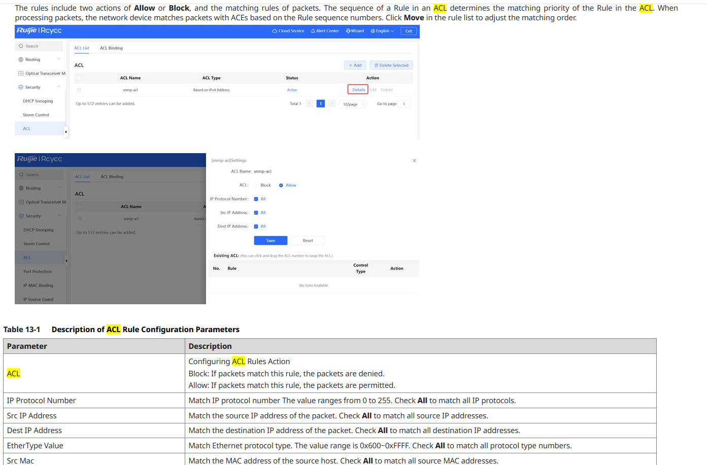

hi there
i just want to know if this layer3 model NBS5200-24SFP/8GT4XS supports extended acl because what i seen in cloud management the only available is the standard acl not a granular type of acl.

Hello sir, the NBS5200-24SFP/8GT4XS supports extended ACLs. Please refer to the device's configuration documentation for details:https://reyee.ruijie.com/en-global/support/documents/slide_rg-nbs3200-series-switches-reyeeos-2340-configuration-guide/?page=html&keyworks=ACL#_Toc210914067
