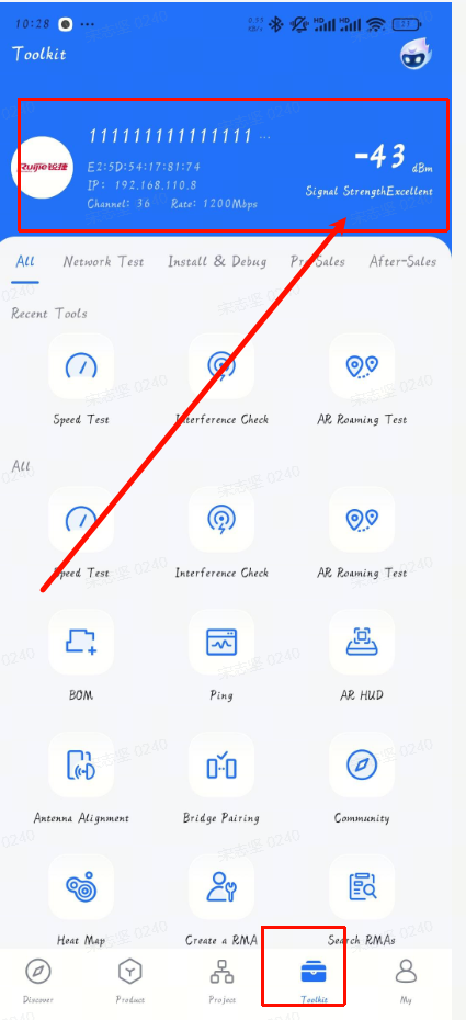

Sir, please check your Wi-Fi settings (specifically power and roaming sensitivity), and then use a Wi-Fi test tool to test your Wi-Fi signal strength.
Refer to the following steps:
1. Set both 2.4G and 5G power to 100%, and roaming sensitivity to 0.
2. Use the Reyee Ruijie app to check the signal strength index (higher is better, -30dbm > -40dbm).
