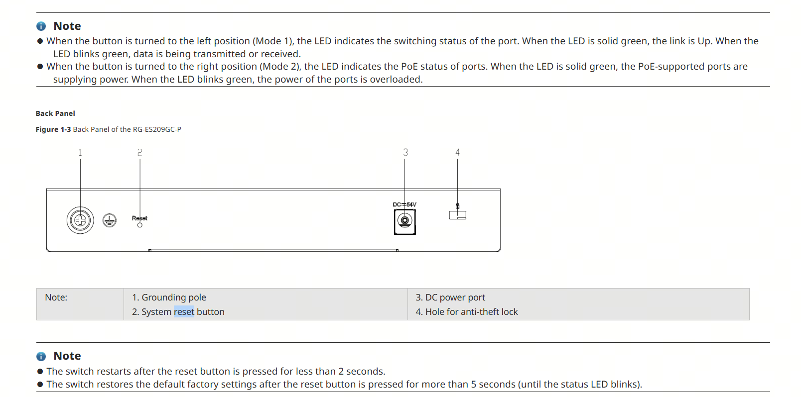

Hi,
You need to confirm what the device prompt message is, preferably displaying an image, and reset the device by holding down the reset button for more than 5 seconds
0 2026-1-11 11:39:47 View all replies
GTAC-Colin replied at 2026-1-11 11:17
Hi,
You need to confirm what the device prompt message is, preferably displaying an image, and reset ...
hola, ya lo intente y no funciona

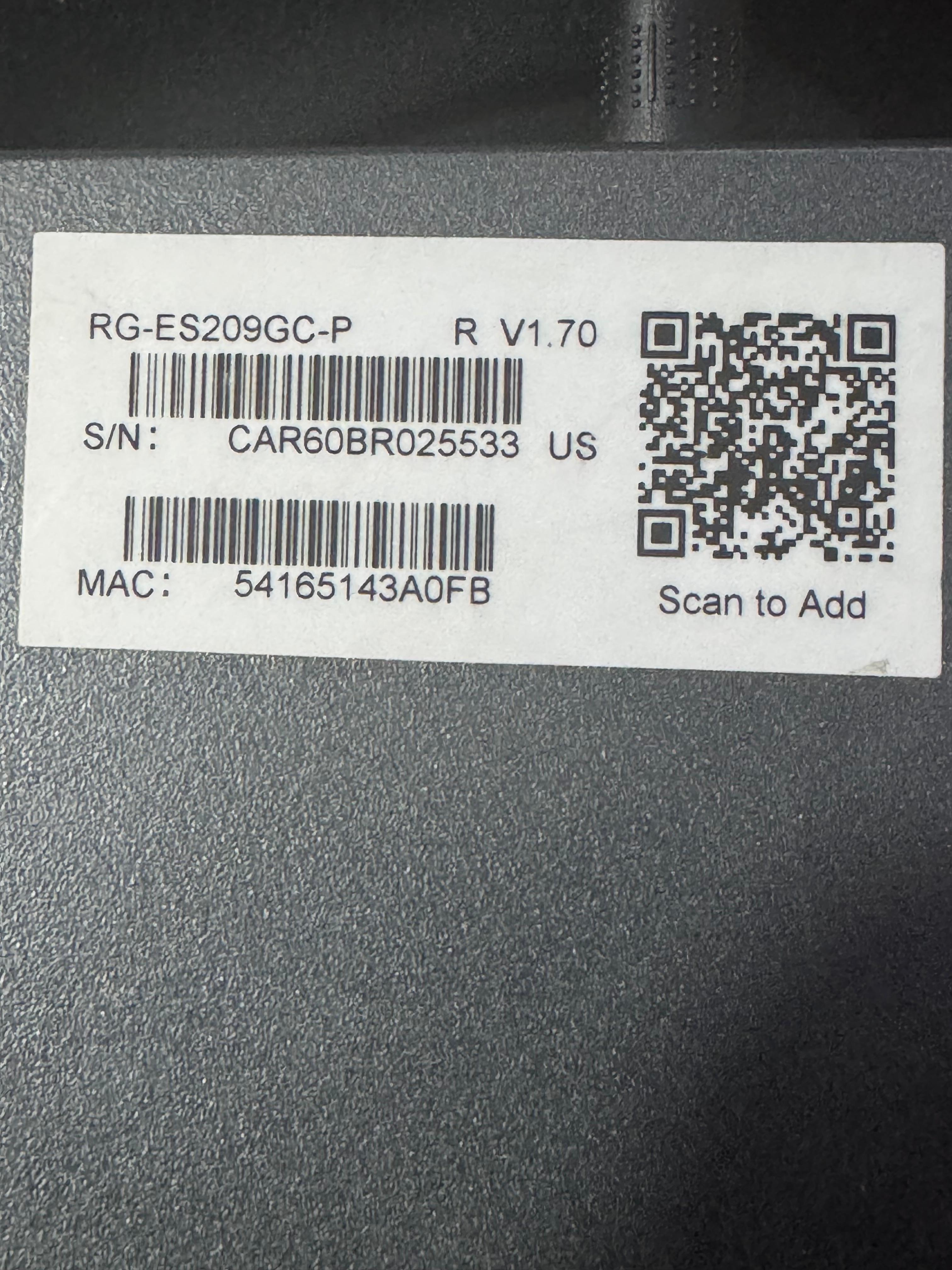

0 2026-1-11 11:55:46 View all replies
Gustavo Agudelo replied at 2026-1-11 11:39
ESTA ES LA ETIQUETA
0 2026-1-11 12:01:12 View all replies

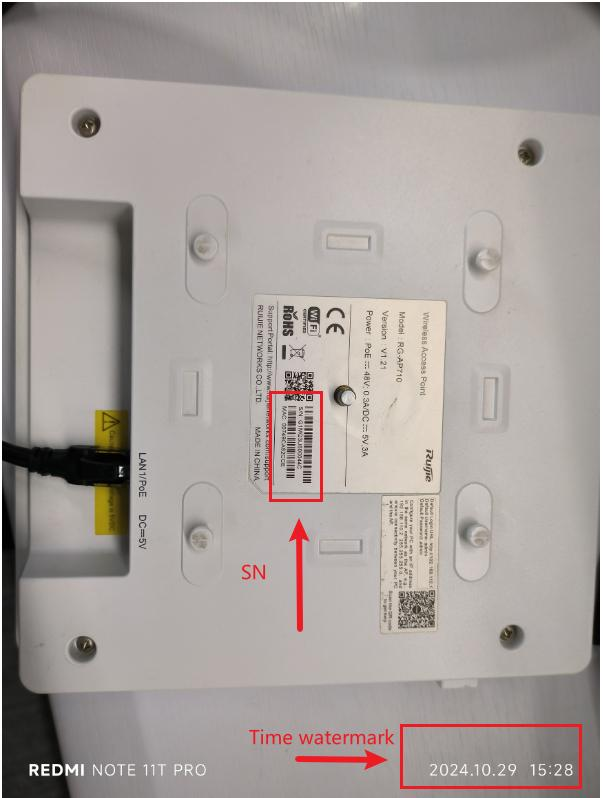

Hi,
Please provide the photo like this.
0 2026-1-11 12:20:57 View all replies

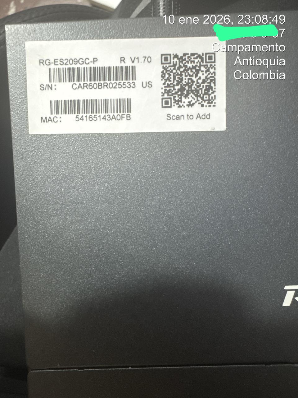

Edited by Gustavo Agudelo at 2026-1-11 12:28
GTAC-Colin replied at 2026-1-11 12:01
Hi,
0 2026-1-11 13:16:42 View all replies

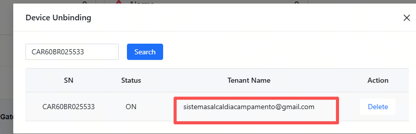

Hi,
The device has been unbinded. You can check that.
0 2026-1-11 13:27:33 View all replies
GTAC-Colin replied at 2026-1-11 13:16
Hi,
EL APARECE EN OTRA CUENTA CON ESTE CORREO duban52@gmail.com, QUE FUE EL PRIMERO QUE HIZO EL REGISTRO, ESA DONDE ME MUESTRAS QUE SE DESVINCULO, ES CON EL QUE ESTABA INTENTANDO REGIsTRARLO DE NUEVO
0 2026-1-11 13:34:46 View all replies
Gustavo Agudelo replied at 2026-1-11 13:27
EL APARECE EN OTRA CUENTA CON ESTE CORREO , QUE FUE EL PRIMERO QUE HIZO EL REGISTRO, ESA DONDE ME  ...
