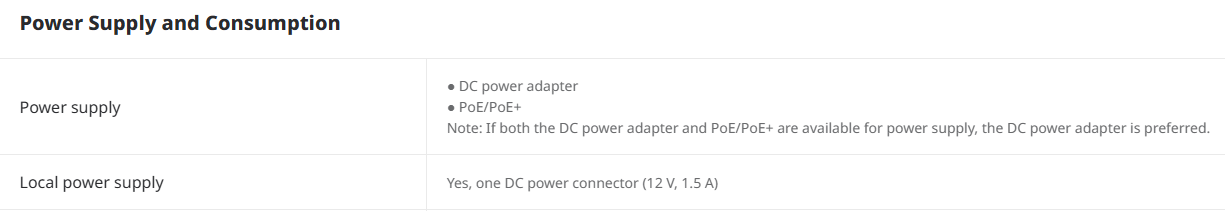

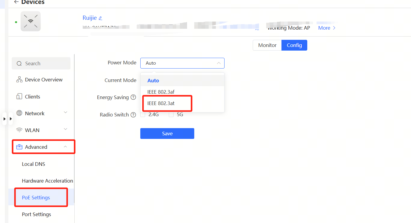

ozden karaca replied at 2026-1-15 13:54
It is powered by a PoE switch.
Dear
Sir, may I know what power supply mode you have currently selected for the AP? Can it be modified to 802.3at? Is there any alarm in the AP?

GTAC-Scenty replied at 2026-1-15 14:26
Dear
Sir, may I know what power supply mode you have currently selected for the AP? Ca ...
Note: This function is only supported by APs running Reyee OS version 300 or later that have PoE alarms. As a result, only APs with PoE alarms are listed here.
It's giving this warning; as far as I understand, it doesn't support it.
