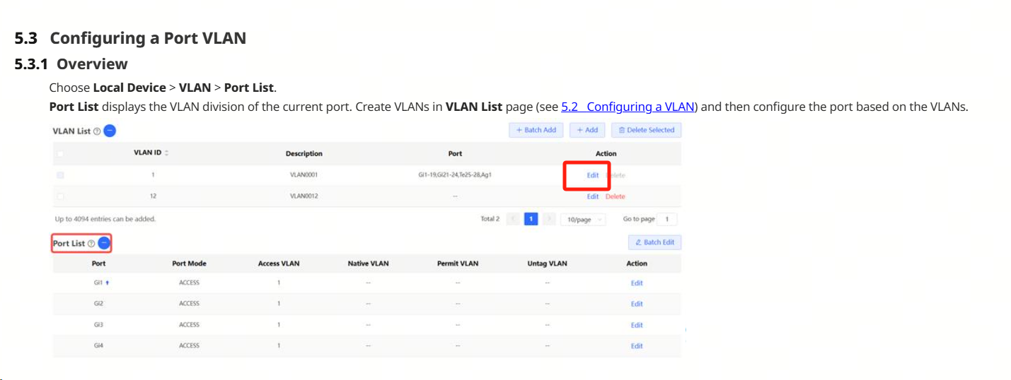

hi support
how to create port profile never seen any option, for eg. port profile1 vlan2 and vlan3 and profile2 vlan4 and 5 so is easy to assign pero without adding vlan one by one in hybrid port option
thanks

Dear
have a good day
Sorry, we currently do not have this configuration. Alternatively, can you directly edit which interfaces belong to this VLAN after VLAN? Or directly allow all VLANs to pass through the trunk interface? Here is the link to the configuration manual ( https://reyee.ruijie.com/en-global/support/documents/slide_rg-nbs3200-series-switches-reyeeos-2340-configuration-guide/#_Ref97293822 ), and I hope it will be helpful to you.
