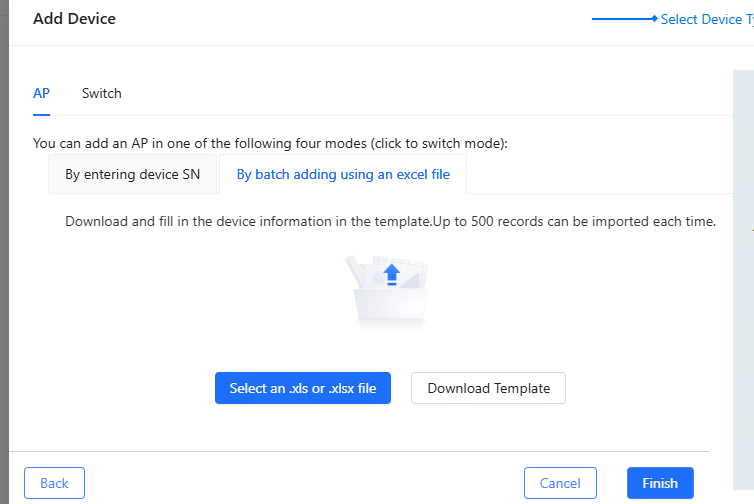

Dear customer,

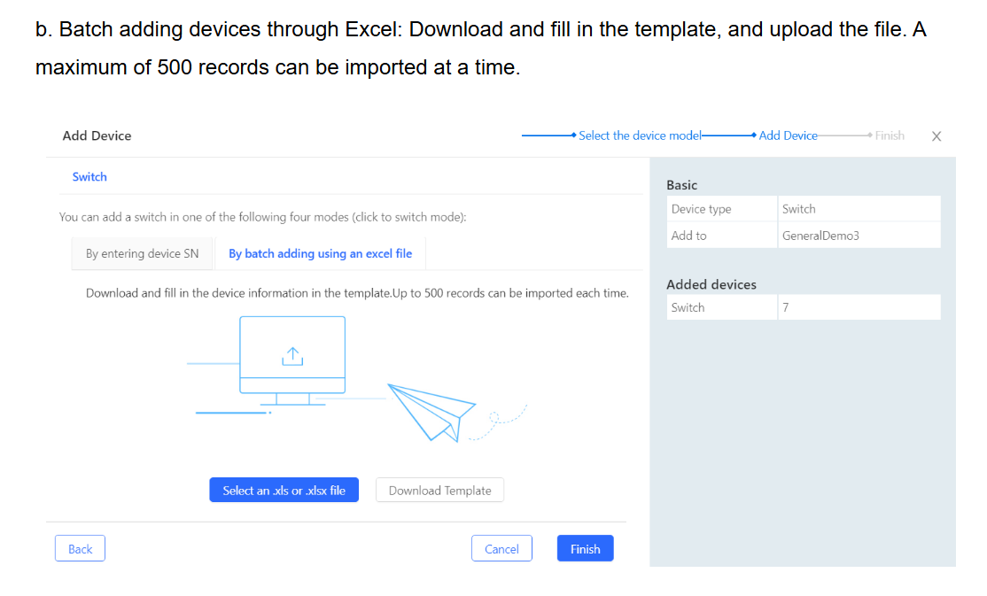

Here are the steps of how you can add device in batch. You can add up to 500 devices a time via this method.

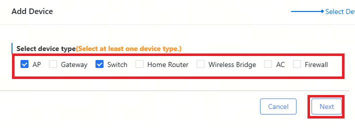

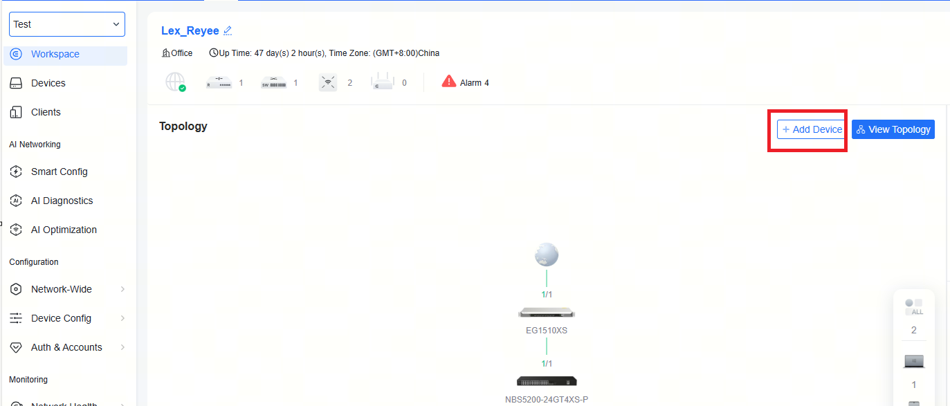

Navigate to Workspace page and click "Add Device".
2. Select the device type and click next
3. Import the table of device you need to add to your project
