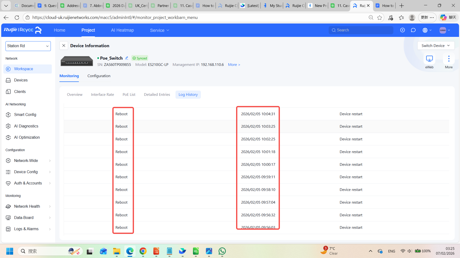

Hi, have you ever run into this case?
The ES210GC-LP ketp rebooting, there are eight HK-VISION devices under it,  7 set of DS-KH6320-WTE1 and 1 set of DS-KD8003-IME1(B).
Is it the power shortage?
And the second question, is it possible that this rebooting can cause the whole network goes down, such as take down the EG105-V2 ?

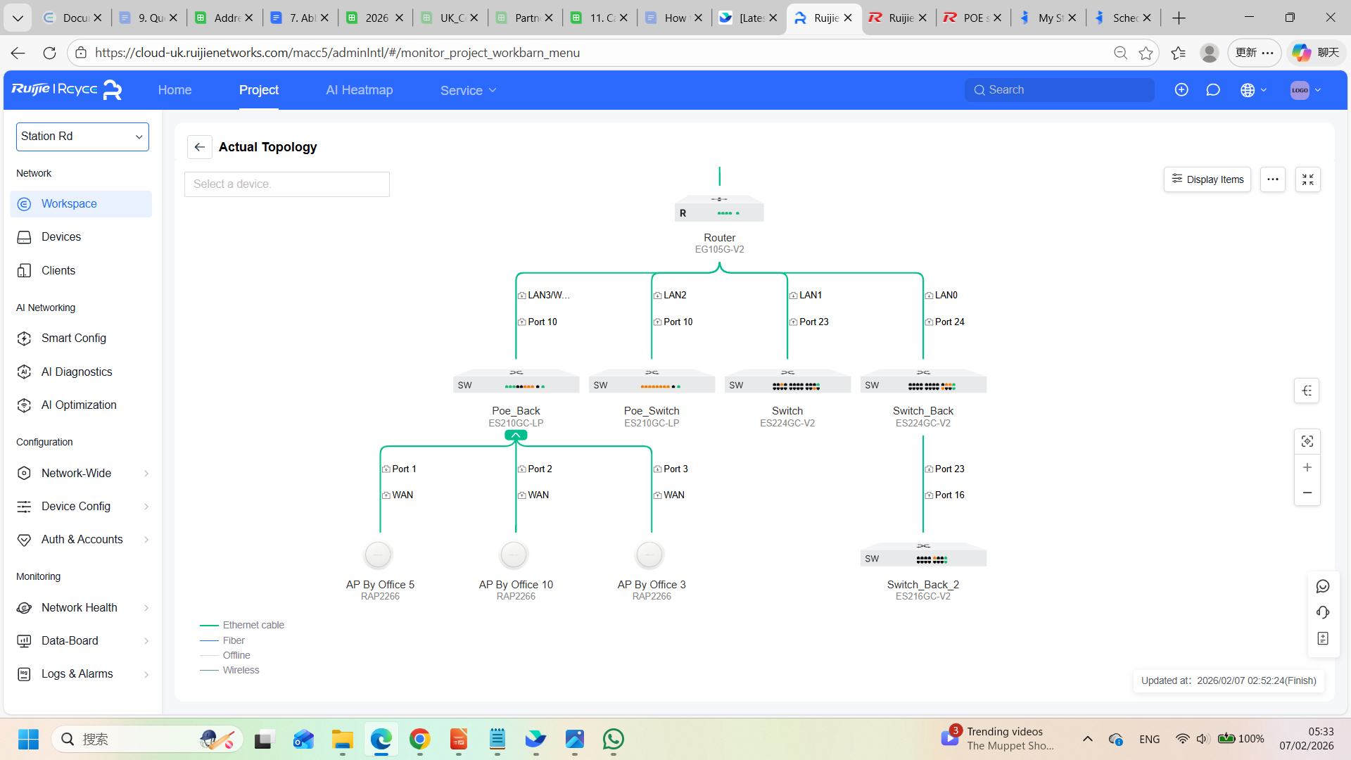

3. May I know your topology? If the ES switch is connected below the EG, it will not affect the EG's network, unless there is a loop in your network.

Hi Steve,
Thank you for your consideration about this problem.
1. They do have another poe switch (named with Poe_Back) with the same model, but without reboot abnormal situations. there are 3 APs, and 3 DS-KH6320-WTE1 under it.
2. The firmware is the latest:

3. Topo is here, the rebooting one is Poe_Switch with 8 orange lights.
