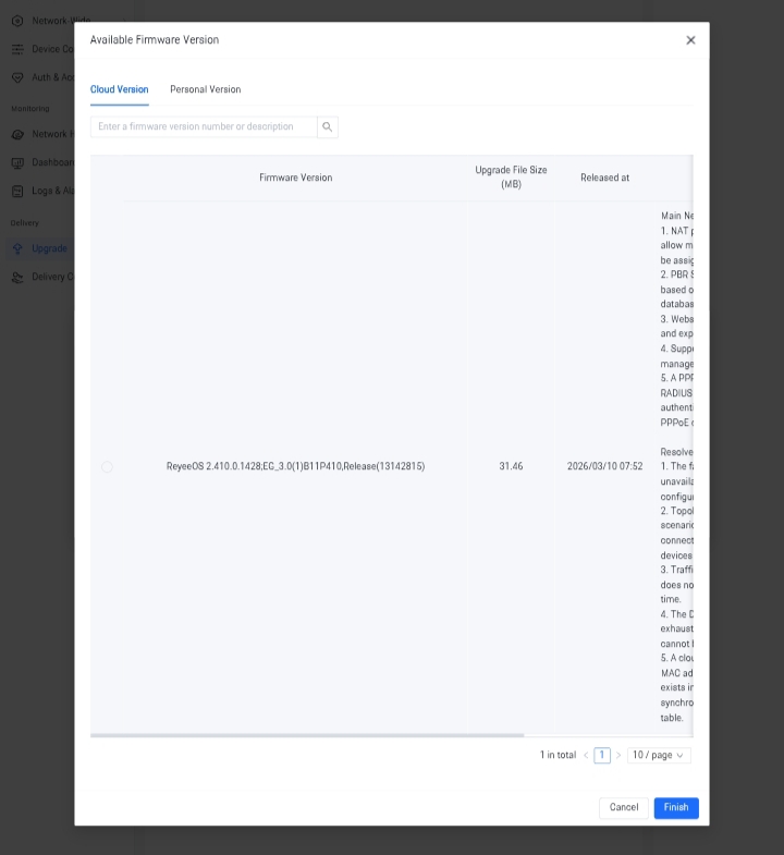

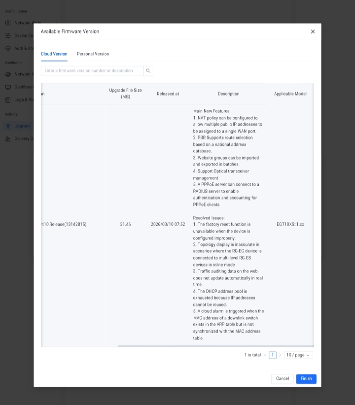

According to firmware, it seem the version 2.342 bit outdated, I've the upgrade page on cloud, there are unselectable version 2.410
It already happen twice since early March 2026.

I checked the latest firmware version is ReyeeOS342 Ruijie RG-EG710XS Series Routers Firmware - Ruijie Reyee
Do you mean that your device has a 410 firmware push in the cloud? If so, please take a screenshot.
We apologize again for the inconvenience caused by this malfunction. We need the environment to troubleshoot the cause.
