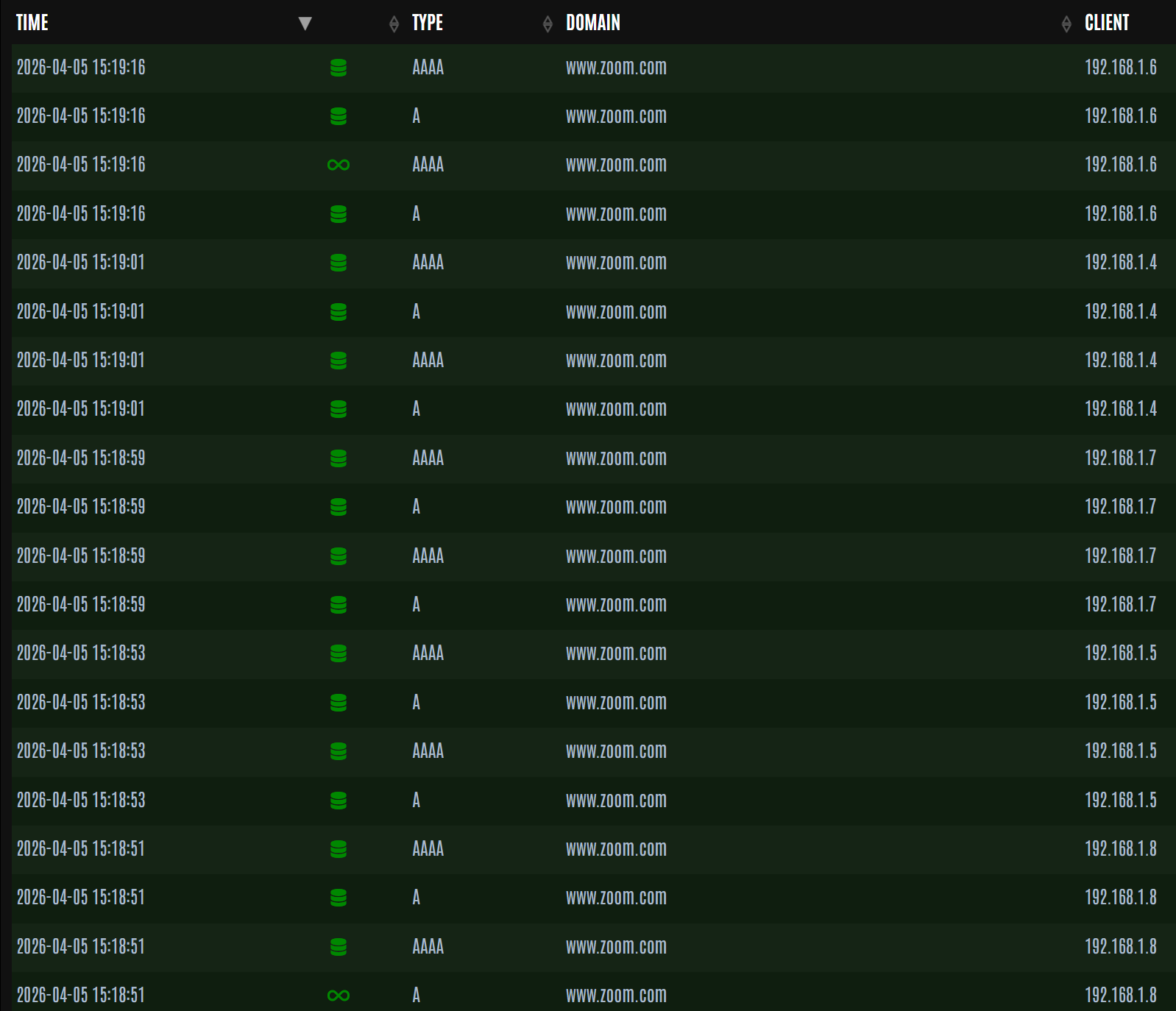

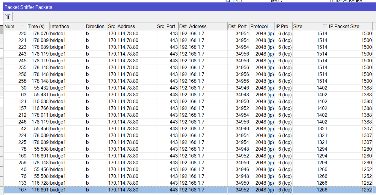

Hi,
My RAP72Pro and RAP73Pro (2.385.0.1403)
APs are constantly trying to connect to www.zoom.com. I have logs from Pi-hole and packet capture as proof.
Besides some checks to Ruijie cloud, DNS and NTP, every else looks normal.
Why are they making these connections?
I have a RAP2200E (2.380.0.2318) that does not have this issue.
Thanks.

For anyone that also wants to diagnose this issue. apparently this is a internet connectivity test, a connection once per minute is done. i can confirm that behaviour. they might release a user configurable option in 420 release.
