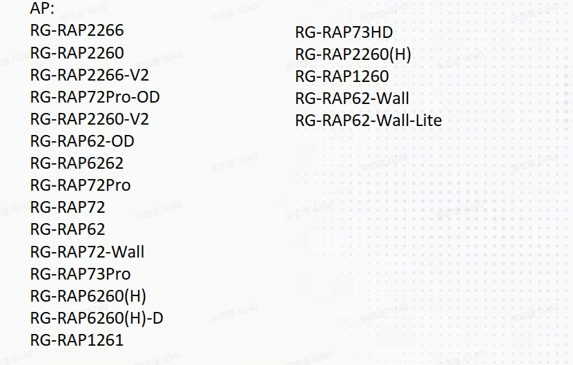

Sir, NBR6215-E does not support External Auth WiFiDog. In order to authenticate the use of APs, all APs in the entire project need to be enterprise level APs or partially reyee APs with version 385 or above that support External Auth WiFiDog. If external portal cannot be enabled properly when mixing with other APs that do not support this feature in the same project or enterprise level APs, the following reyee AP models are supported:
According to your description, if there is RAP-6260 (G) in your project, then your project cannot enable external wifi dog authentication properly
