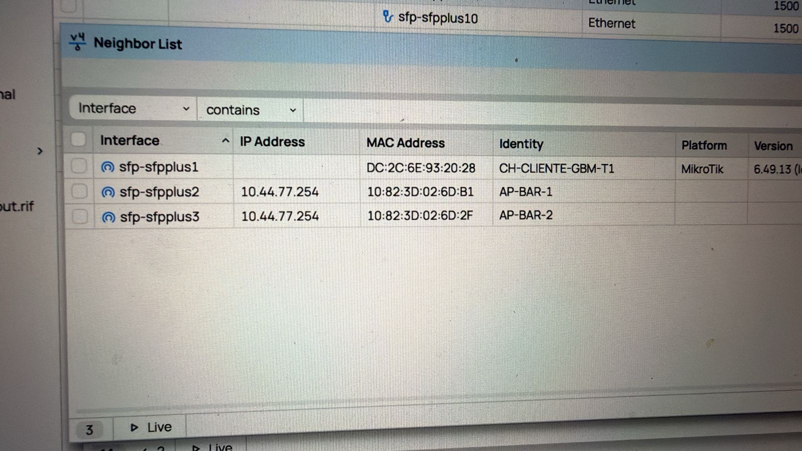

I have a MikroTik router with three RAP73Pro access points and two RAP6260s connected. Why do only the RAP6260s appear in the Neighborboard section of the MikroTik router, and not the RAP73Pros?

Dear customer
I hope this email finds you well.
I suggest you follow the following steps to investigate
1. Complete the AP settings to obtain the correct IP address. I see that your AP still has the default IP address of 10.44.77.254. If the settings are completed normally, it should be another IP address
2. Check the connectivity between the AP and Microtik, you can perform a ping test on the AP
3.If the above tests are normal but still cannot be displayed on Microtik, you can consult Microtik's technical support to inquire about the root cause of the inability to display
