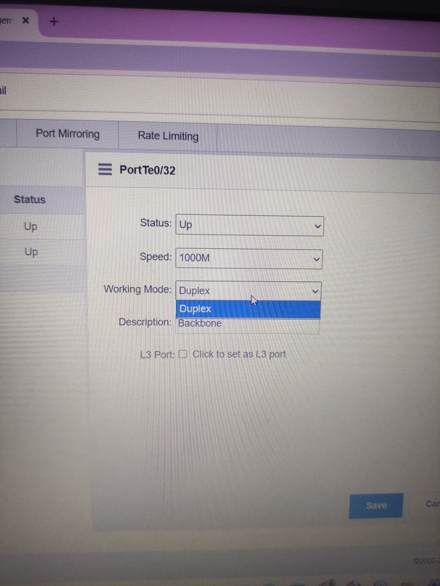

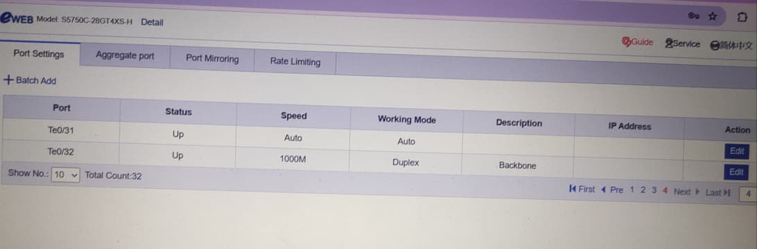

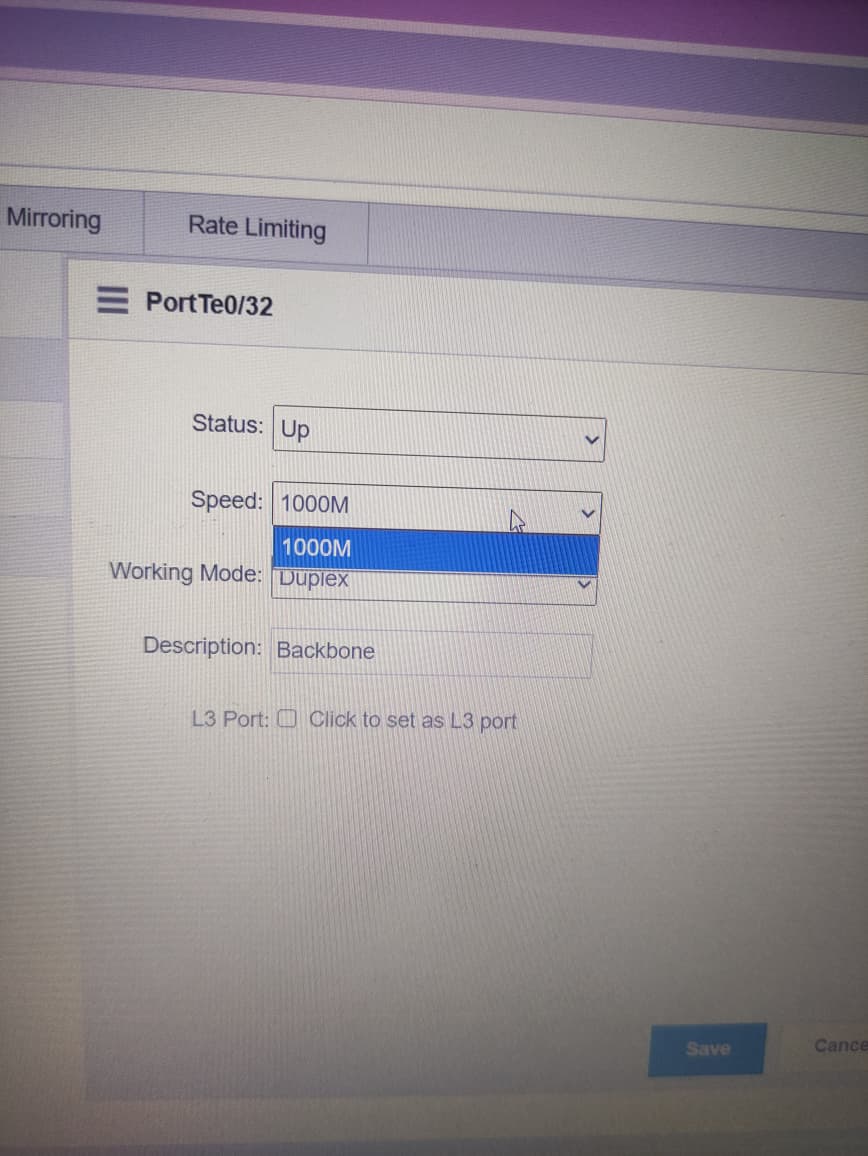

why i can't change speed and working mode on sfp port. i already change sfp module and sfp support 10G, but menu still cant change manualy, only for sfp port, rj45 port can change manualy

There is no notification, when I click edit, it looks like the picture.

Dear
Sir, could you try editing other unconnected ports? The interface you are currently editing appears to have negotiated 1000M. Is the optical module you are using 1G or 10G?

when i edit unconnected port it same looks like the picture, when i change via CLI, its work, the speed and working mode can set to auto
