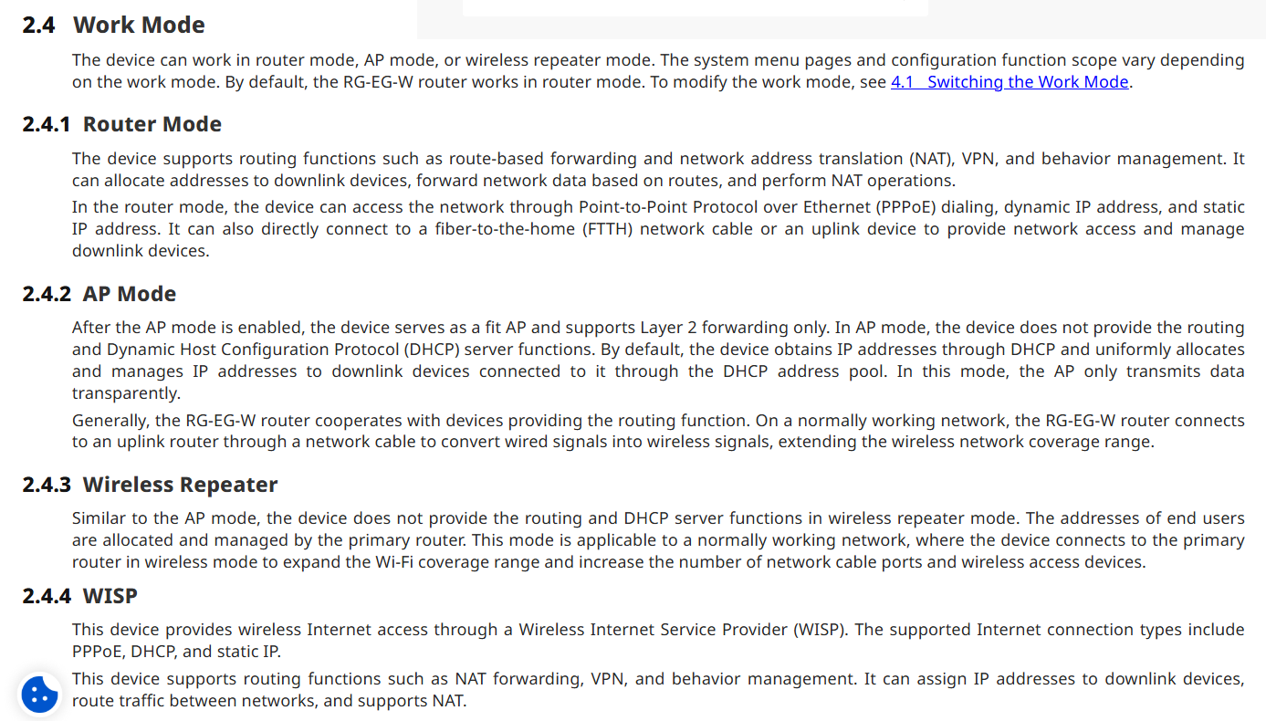

Hello, the device model RG-EG105GW-X is a wireless router, as long as one of them is in AP mode, your goal can be achieved (it's not recommended to have 2 devices working in router mode).
Here you can find more information about the working modes:
https://reyee.ruijie.com/en-global/support/documents/slide_ruijie-reyee-rg-eg-w-series-wireless-routers-reyeeos-2-380-configuration-guide/#_Toc216452634
Regards.
