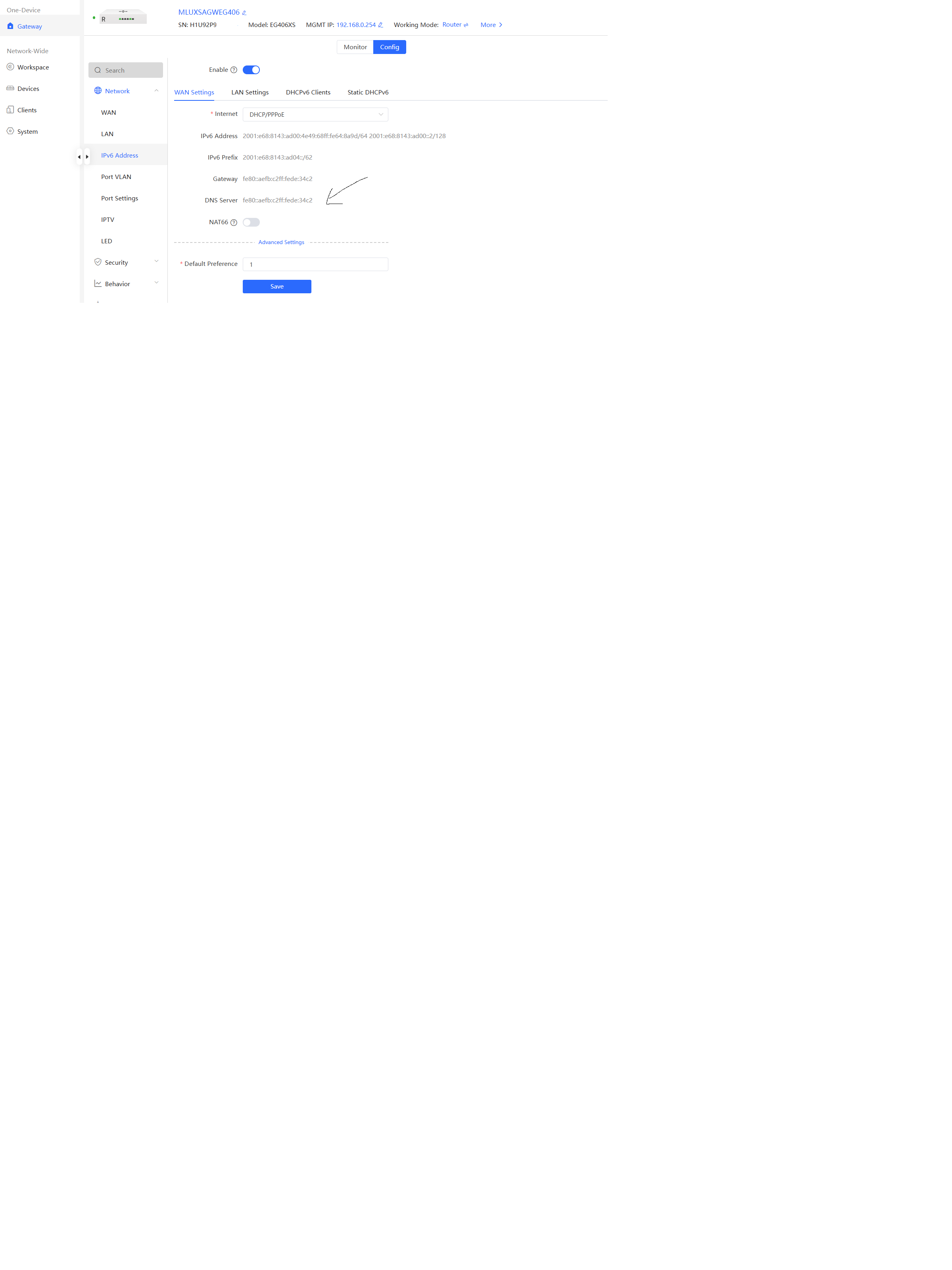

Dear Support,
Kindly please how to key in PV5 DNS address On IPV6 Address WAN setting, there is not place to allow to keep in  IPV5 DNS address
as show on attachment file
RG-EG305GH-P-E
Router Other Configuration

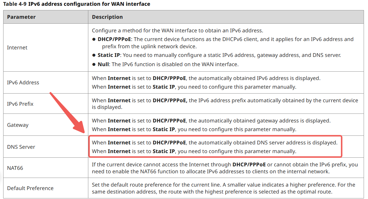

Hello,
Can you elaborate a little more about what do you mean by IPV5?
Also, you can refer to the device manual to check the device configuration settings:
https://reyee.ruijie.com/en-global/support/documents/slide_reyee-rg-eg710xs-router-reyeeos-2-342-configuration-guide/#_Toc209441168
Section: 4.8   Configuring IPv6, show the IPv6 related configuration.
For the DNS settings, you may have to configure the internet setting to static to manually set the DNS:
Please let us know if this works for you.
Best regards.

Dear Sir / Jason,
thank you for your reply , sorry typo error should be IPv6 DNS address on the IPv6 WAN section to fill up DNS IPv6 address instead get from ISP
Anyway, I  will follow the Document that you send to refer it.. any issue will get back to you
Thank you
