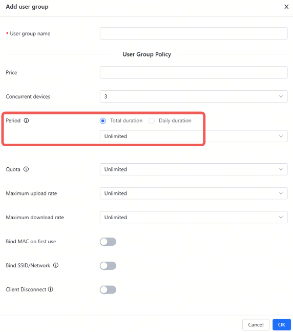

Most probably the configuration of the group management is not appropiately configured. Are you setting a time period?
https://cloud.ruijienetworks.com/help/#/ArticleList?id=6b61d7e442974ab7a5762b02c1791c5a
Also, is your NAS device (the device that manages your captive portal) firmware up to date? are you using a gateway or an AP as the authentication device? have you tested the voucher and confirmed if it still provides access to the internet?
Please let us know. Regards.
