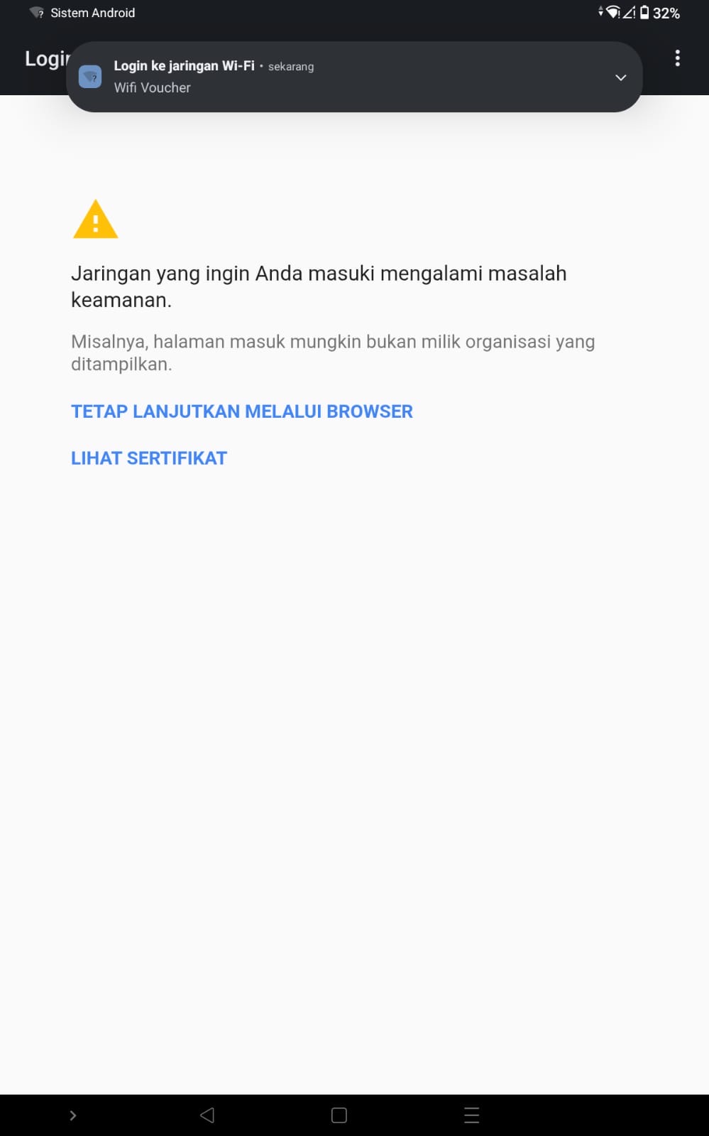

Hello. For this few days already we have problem with captive portal. We use it to enter voucher code.
It shows certificate problem.
When we tries to keep continuing, the site would error “too many redirect”.

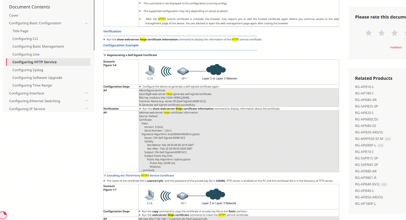

Where can I find this HTTP certificate?
0 2026-8-13 18:24:50 View all replies
iwan chandra replied at 2026-8-5 14:03

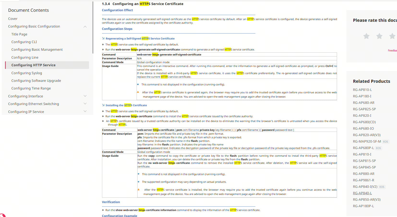

You can check out section 1.3.4 'Configuring an HTTPS Service Certificate' in this manual. You can also run 'show web-server https certificate information' to see if the certificate has expired.
The suggestion is to import the CA certificate (Installing the Third-Party HTTPS Service Certificate). You need to buy a CA certificate from a third party.
