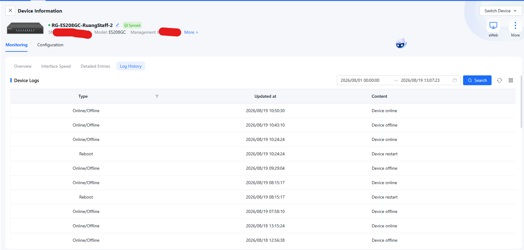

While the first Ruijie switch is running perfectly without any issues, the second RG-ES208GC keeps randomly dropping offline, coming back online, and occasionally rebooting by itself.

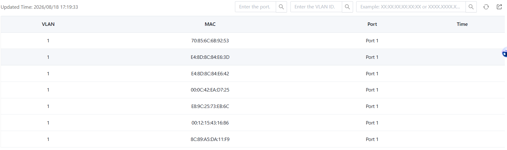

New Observation (MAC Address Table):I checked the management interface on the problematic switch, and I noticed that Port 1 (which is the uplink port connected to the CRS125) is logging multiple different MAC addresses.

  • Why does this specific device detect several MAC addresses on Port 1, while my other Ruijie switch only detects one MAC address for the CRS125 uplink?

4. For the switch's automatic restart problem, it's usually caused by a power supply issue. You can try swapping the power adapters of the two RG-ES209GC-P switches.
5. For the MAC address table issue, you can first check if these MAC addresses are also present on the CRS125.
