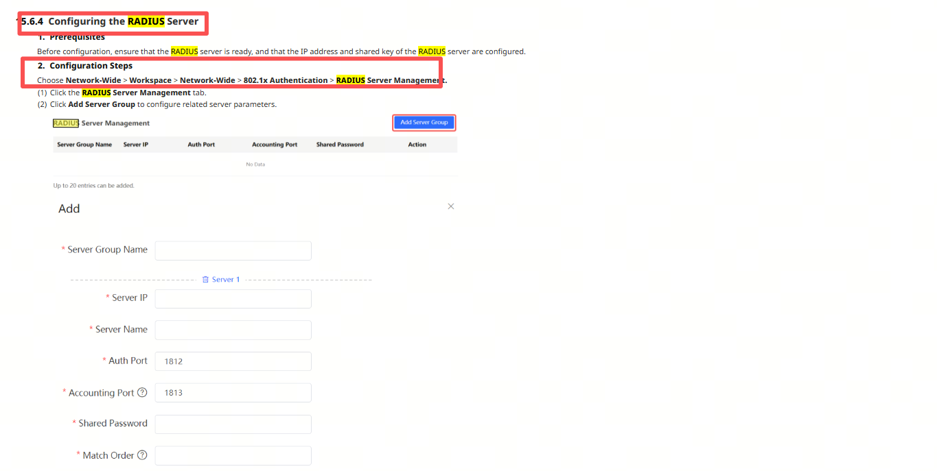

Dear
Sir, you can refer to the RADIUS Server configuration instructions in the manual here. Please feel free to let me know if you have any further questions.
https://reyee.ruijie.com/en-global/support/documents/slide_rg-eg-series-routers-reyeeos-2-430-configuration-guide/#_Toc236837771
