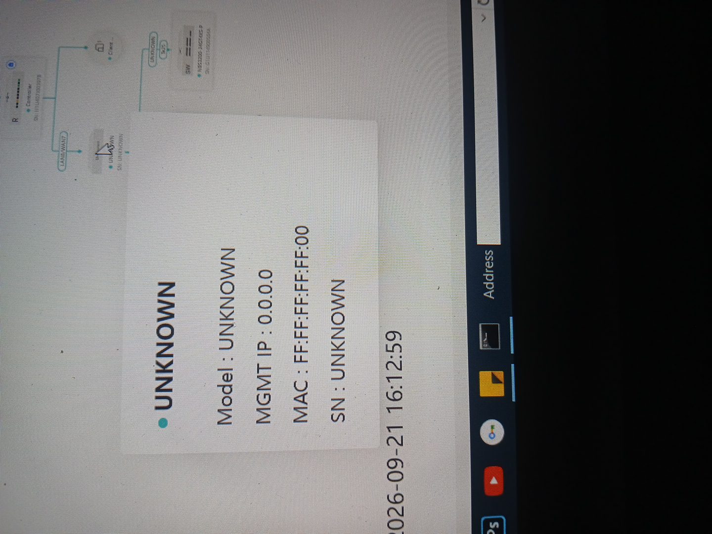

I am facing an issue connecting a Ruijie Enterprise Core Switch to a Reyee/EG Controller.
  • Controller Model: RG-EG1510XS
  • Switch Model: RG-S5750C-28SFP4XS-H
  • Switch Firmware: RGOS 11.4(1)B12P8
Problem Description:
The switch appears in the controller's web interface as UNKNOWN with an IP of 0.0.0.0 and a fake MAC address (FF:FF:FF:FF:FF:00).

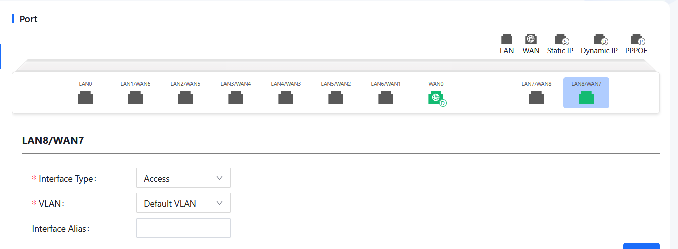

Sir, you can check the switch LAN8/WAN7 Check whether it is indeed connected to a real existing device; if not, please verify that the VLAN configuration of the interface is correct.
0 2026-9-24 16:37:28 View all replies
GTAC-Morning replied at 2026-9-24 00:23
Sir, you can check the switch LAN8/WAN7 Check whether it is indeed connected to a real existing devi ...

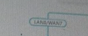

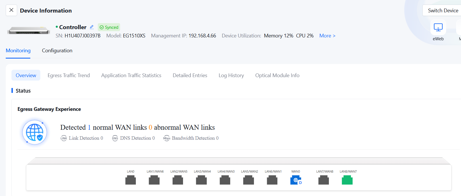

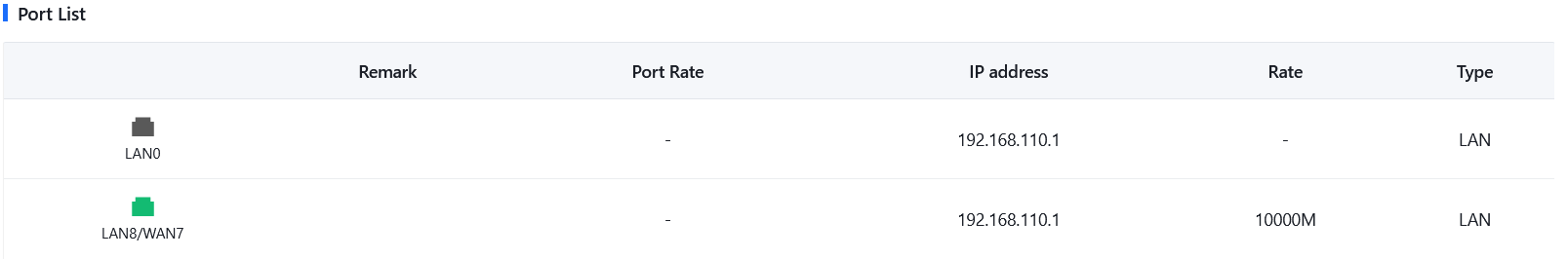

Thank you for your response.
I would like to clarify that the LAN8/WAN7 port is a port on the controller, not on the switch.
This port is physically connected to Port 31 of the switch.
The attached images provide a clearer overview of the network topology and the connection between the controller and the switch.
