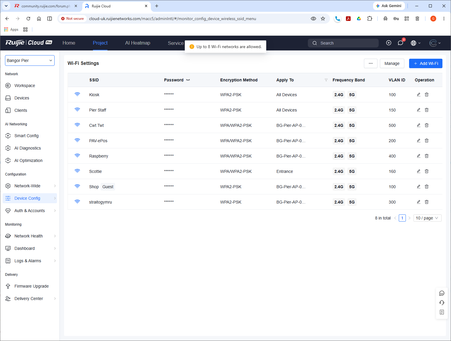

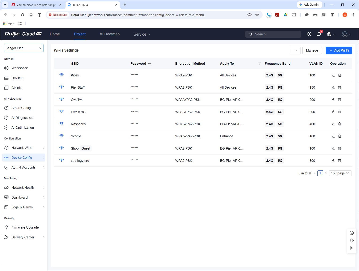

Thanks for the reply.  2 screenshots uploaded.
The first from the Ruijie Cloud: - project-> device config-> wireless-> wi-fi
The second when I click add wi-fi top right of the same page, showing the alert message.

You have already reached the maximum limit of 8 SSIDs. If you need certain access points (APs) to broadcast different SSIDs, you should create a device group. Within the Wi-Fi configuration, you can then remove or add SSIDs as needed. Once configured, move the desired APs into this device group by selecting them and assigning them to the group. After the settings have synchronized, the new SSIDs will be active on those APs.

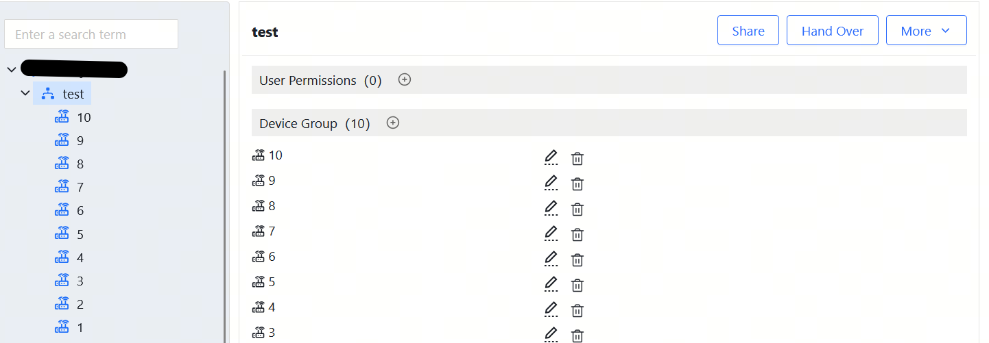

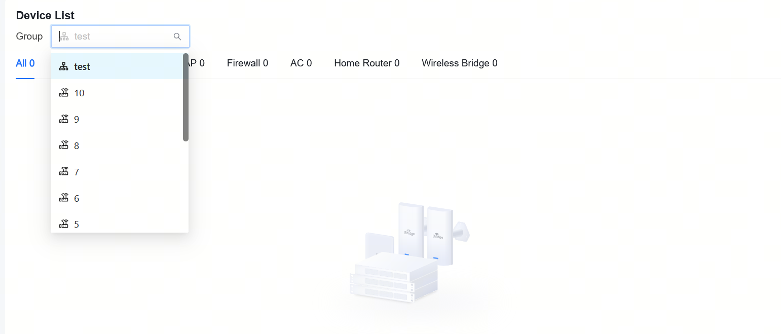

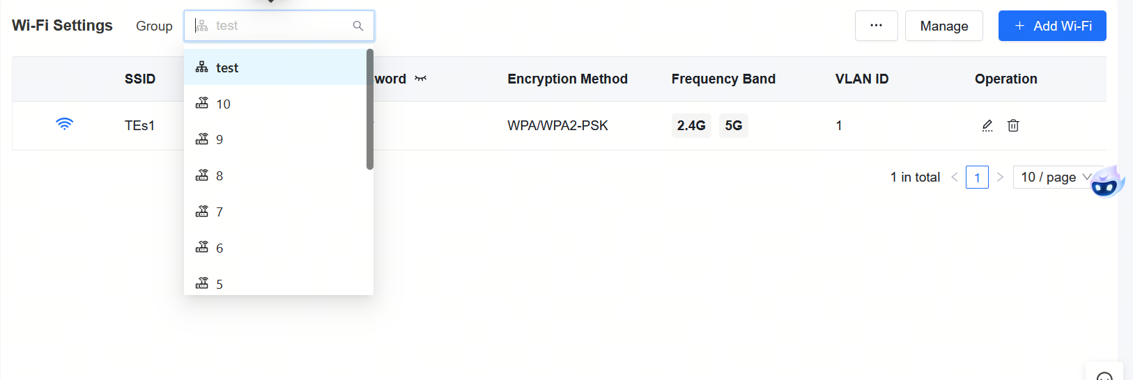

Please verify that your device group looks like this so that you can switch SSIDs between device groups; you have already reached the maximum number of SSIDs that can be created.
In the Wi-Fi settings, you will be able to switch between device groups to configure the appropriate SSIDs required.
In the list of devices, you must select the device you wish to move between groups, so that you can manage the SSID you want to implement for that specific group.

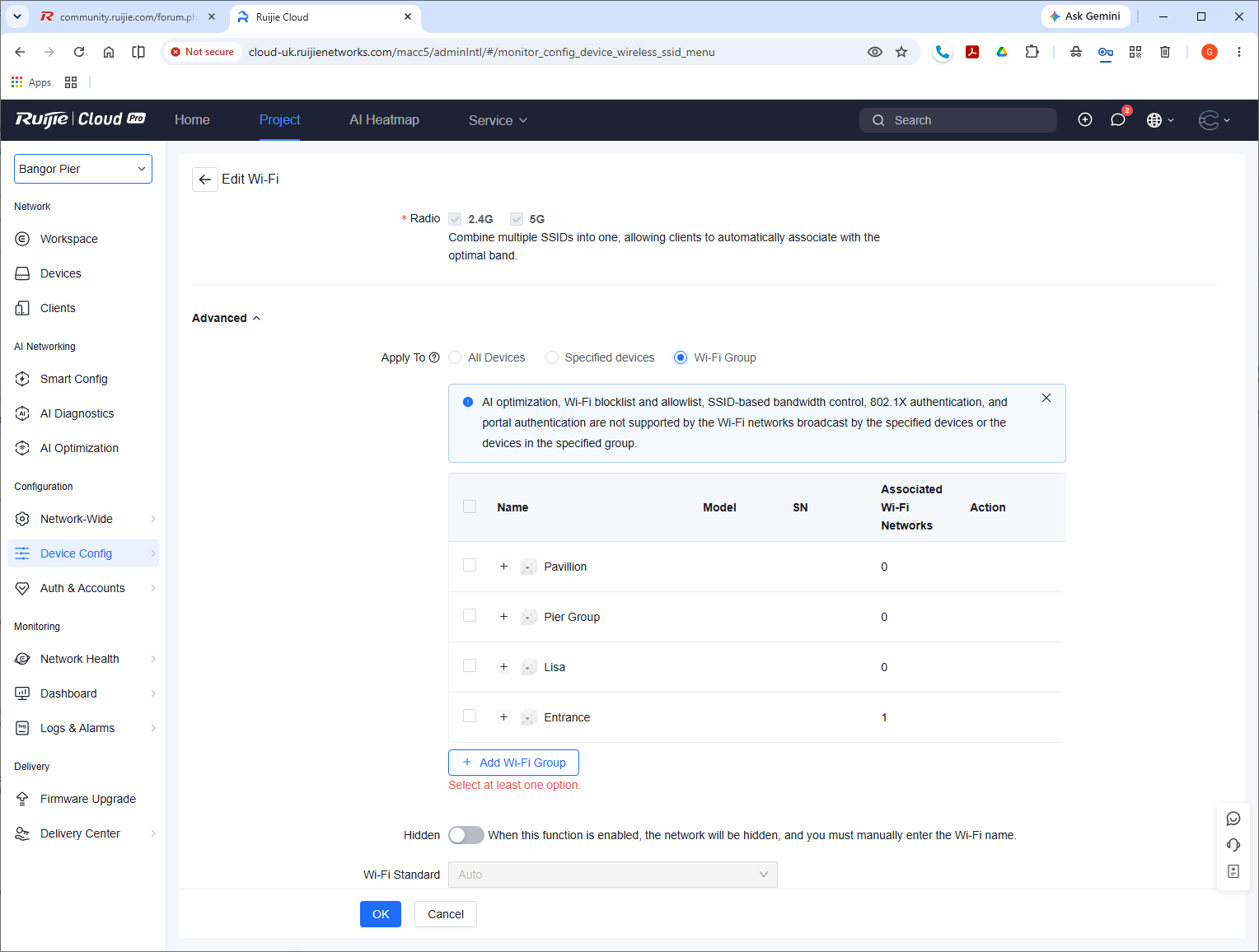

Sorry, but I don't think you understand that I have already got AP Groups configured.
Your Cloud Platform looks different to mine, I don't have the Groups option on the Wi-Fi page, it's contained in the SSID setting page.
