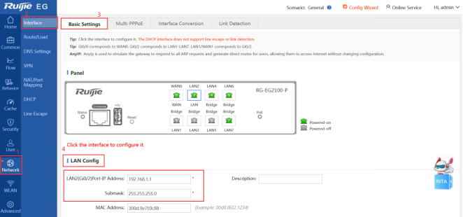

Step 1: Configure the corresponding gateway ip address on the EG LAN interface
Choose Network > Interface > Basic Setting > LAN Config, for example, if the IP address of VLAN 1 is 192.168.1.x, configure the gateway address as 192.168.1.1.

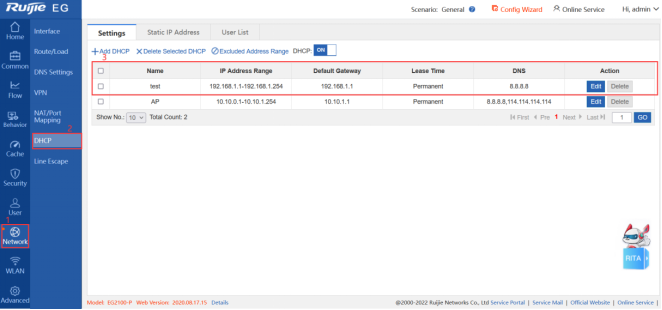

Step 2: Enable DHCP function and configure DHCP server configuration on the EG
Choose Network > DHCP > DHCP button > Add DHCP, the the address pool range is in the same address segment as gateway address.
