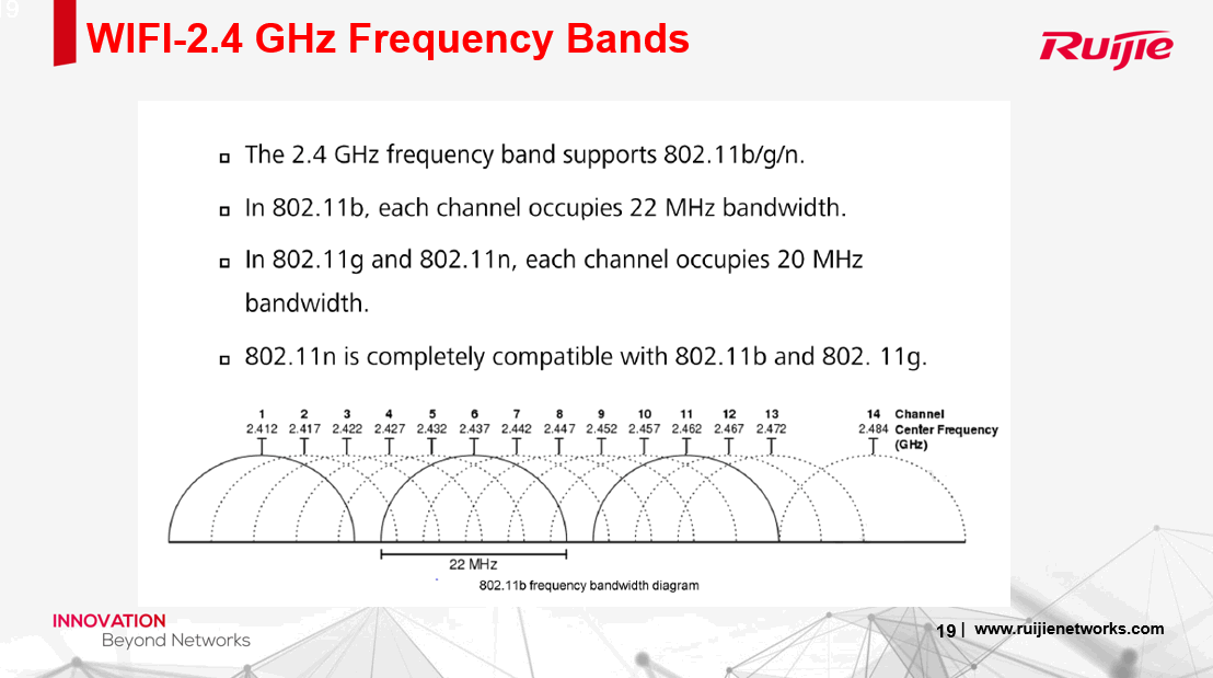

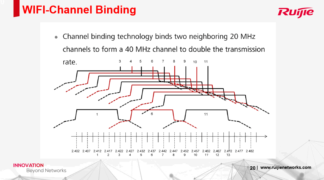

You may know each 2.4 Ghz Channel occupies 22 MHz bandwidth. During you select 40 Mhz or 80 Mhz will double or triple the transmission rate, We call as Channel binding technology.
