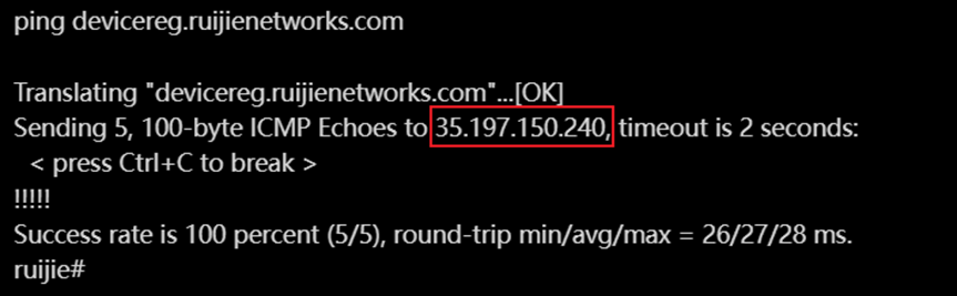

1)  Verify the connectivity between Ruijie device and Ruijie Cloud.
          ping devicereg.ruijienetworks.com on device CLI.
Notice:
devicereg.ruijienetworks.com different cloud resolution IP addresses are different
Cloud-as should be 35.197.150.240
Cloud-eu should be 3.74.187.175
Cloud-la should be 3.74.187.175
If the resolved IP of device reg.ruijienetworks.com isn‘t right. Go to step 6 to manually modify the cwmp setting.

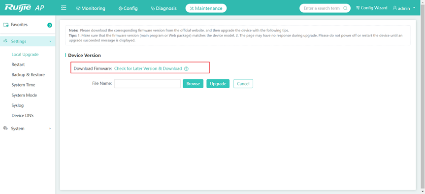

4. Check Device Firmware
    Whether the device is running the latest firmware as Ruijie Cloud recommended, if the firmware version is too old, it may not be compatible with Ruijie Cloud.

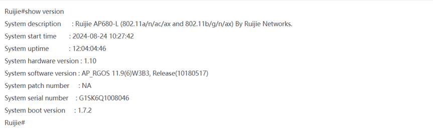

7. Check Serial Number
Whether the device's serial number is matched with the one displayed on Ruijie Cloud. The serial number can be found on device back panel or exec "show version" on CLI.
