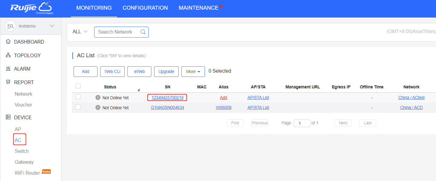

Step 1  Click devices SN to enter Device Details

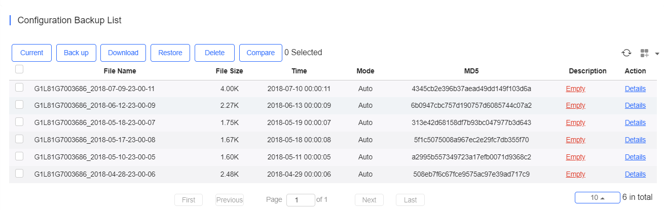

Step 2 find out the configuration back up list
Step 3 choose the latest backup configuration, and then click download
Notice:
Once the devices configuration was changed,will auto back up here
