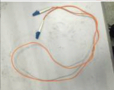

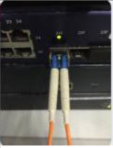

a)  Check whether the optical fiber transceiver is inserted reversely
Pull out the optical fiber, switch the transceiver end of the optical fiber, insert it again, and check whether the indicator light of the optical port is on.

f) Single-coretransceiver self-loop test
Use a single-core fiber to short-circuit the transceiver ends of the optical module to check whether it is Link up. If the port led indicator is blink, which means the port and the  module is normal. Please check the switch configuration and optical transceiver power.
If the Linkup fails, the switch port or optical module is damaged. Please replace it one by one.
