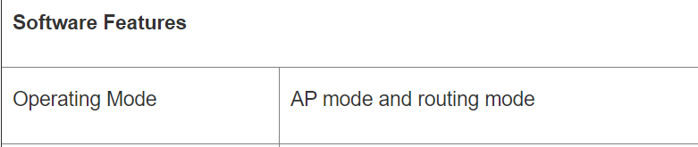

Reyee AP can support work in AP mode and Routing(Router) mode.

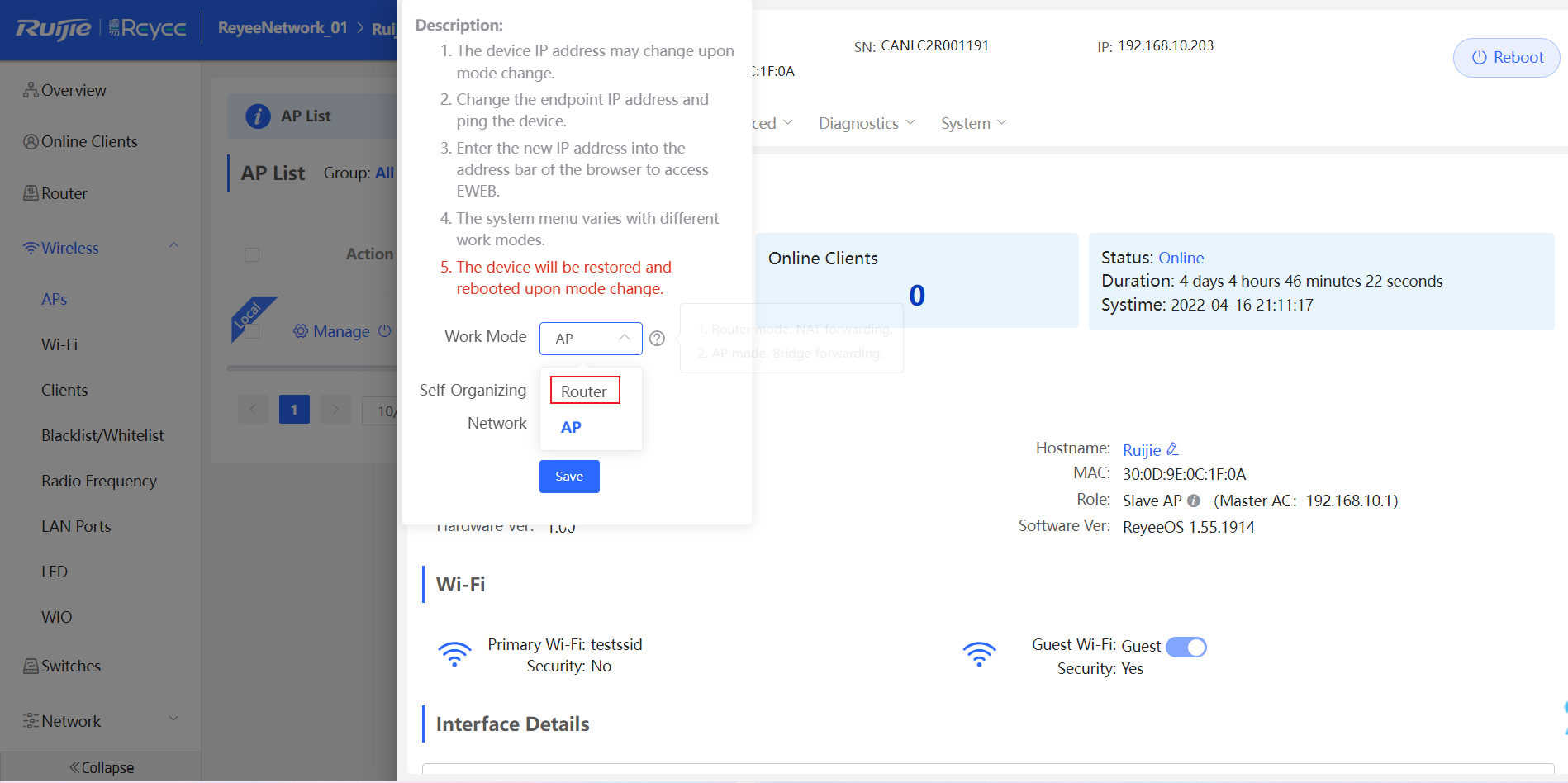

You can change the work mode for Reyee AP in its web page.
<span style=""">Notice: The device will be restored and rebooted upon mode change.
</span>
