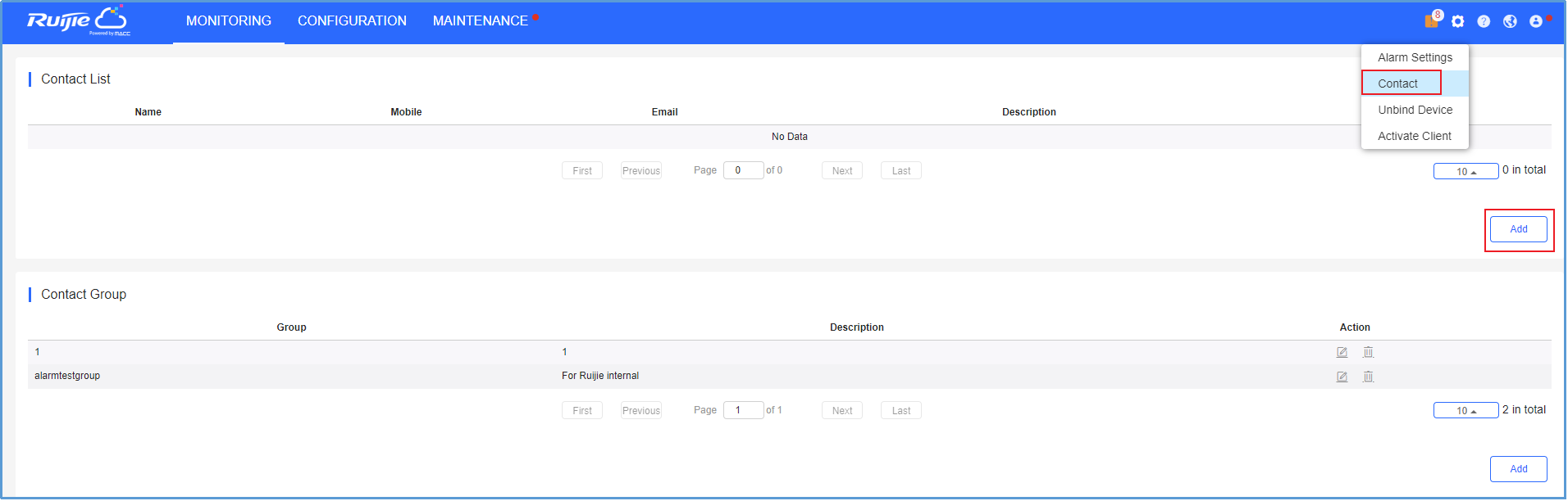

a) Add contact information

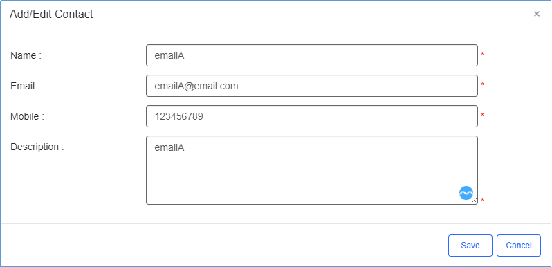

1)Enter ”Contact” page to add Contact List.
2)Enter Name, Email, Mobile and Description and click Save.

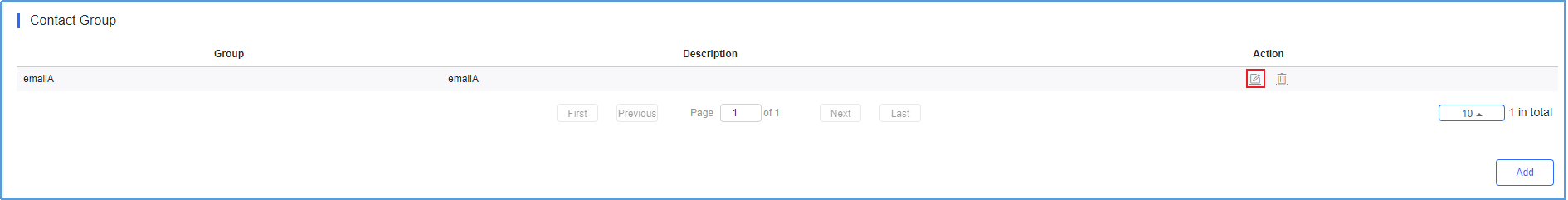

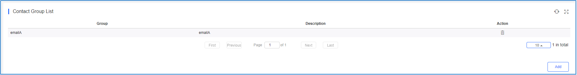

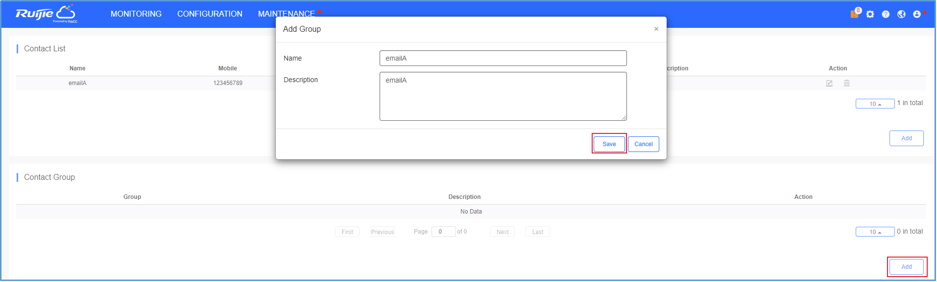

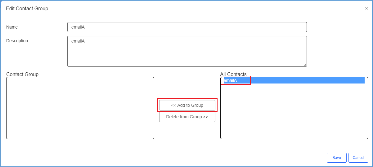

3)Add a Contact Group
4)Add the contact list to contact group.

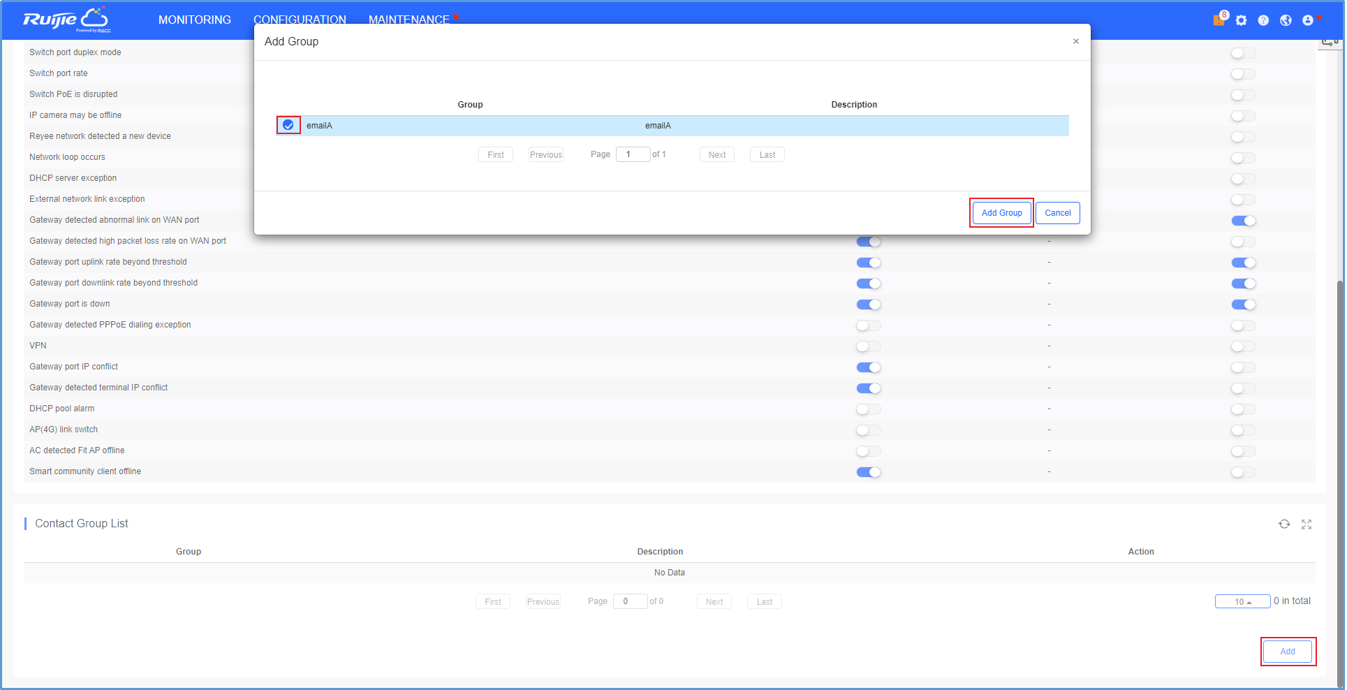

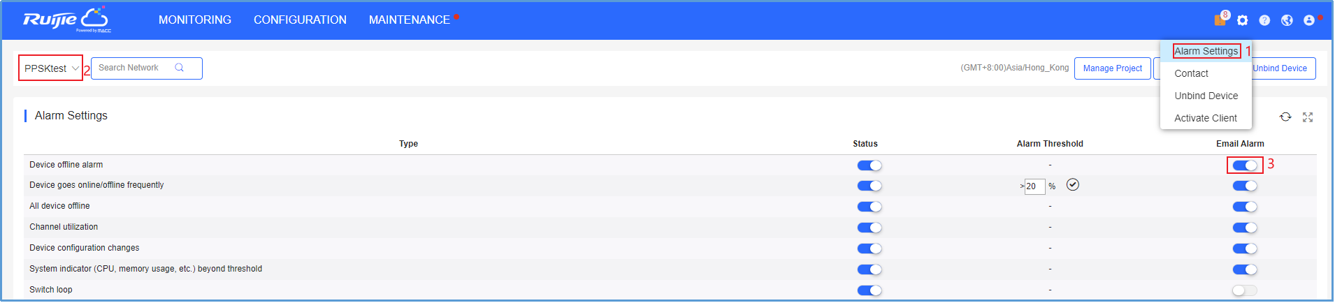

b)Alarm setting
1)Enter Alarm setting page > select network > enable “Email Alarm”
2)Add Contact Group List
config
