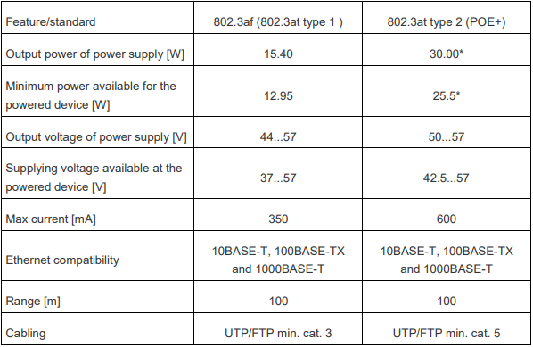

Comparison of 802.3af and 802.3at

Depending on the transmitted power and data rates, the 802.3at standard encompasses 2 versions:
type 1 - for devices compliant with 802.3af and with power transmission employing 2 pairs of min. Cat.3 cable, with max output power of 12.95 W
type 2 - with max output power of 30 W, transmitted via min. Cat.5 cable

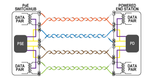

Wiring diagram for a PoE switch (endspan) and an 802.3af (802.3at type 1) powered device.
Option A - violet color, option B - yellow color

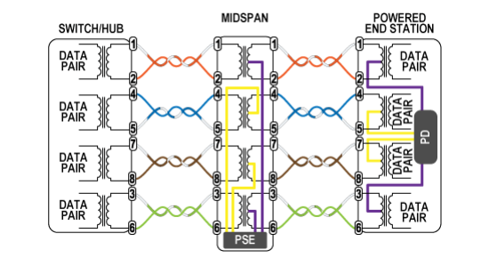

Wiring diagram for a PoE injector (midspan) and an 802.3af (802.3at type 1) powered device.

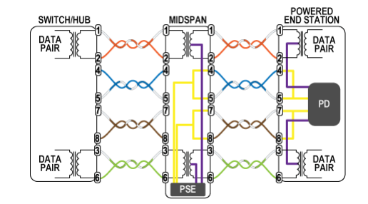

Wiring diagram for a PoE injector (midspan) and an 802.3at type 2 (PoE+) powered device.

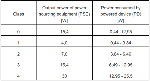

Optional classification of equipment compliant with 802.3af standard provides useful information aboutits power requirements. It is based on the measurement of the current flowing when testing the connection.
The equipment is classified as follows:
Devices compliant with 802.3at also communicate with one another using Layer-2 power management protocol for enhanced power allocation, LLDP-MED (extended version of the protocol for auto-detectionof devices). With such communication it is possible to determine the actual power demand with accuracy to 1.11W. The power supply unit forwards the information on the demand for power at regular timeperiods.

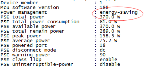

What can we do if the AP cannot be powered to connect to the PoE switch?
Step1: If the switch does not have enough power then it won't actually overload itself, it's just that some ports will not get an power delivered to them.
The command CLi will help you to check whether the power is enough or not:
Ruijie#show poe powersupply
Step2: If the power is enough, try to enable the PoE
compatible mode.
  • Enable the energy-saving mode.
Ruijie(config)# poe mode energy-saving
  • Enable the Poe legacy
Ruijie(config)#poe legacy
Ruijie(config-if)#poe legacy   -----some switches need enable under the interface.
