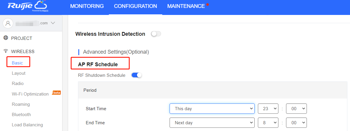

Do you want to know how to Disable/Enable SSID at particular time using Ruijie Cloud?
There is no option on AP eweb to do this do the best way is using Ruijie Cloud.
Procedure:
The AP is online on the Ruijie Cloud.
WIRELESS > Basic > AP RF Schedule.
Select the time and disable the AP radios.

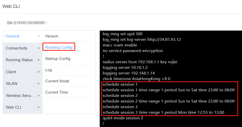

Check the command on web cli.
