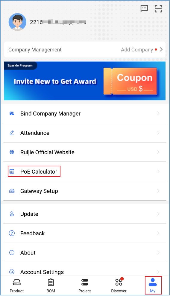

Path: Cloud APP > My > PoE Calculator

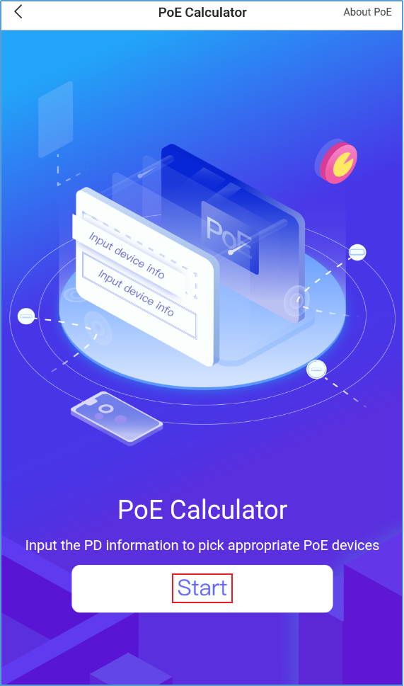

Step 1: Click “Start” to enter the POE calculator interface

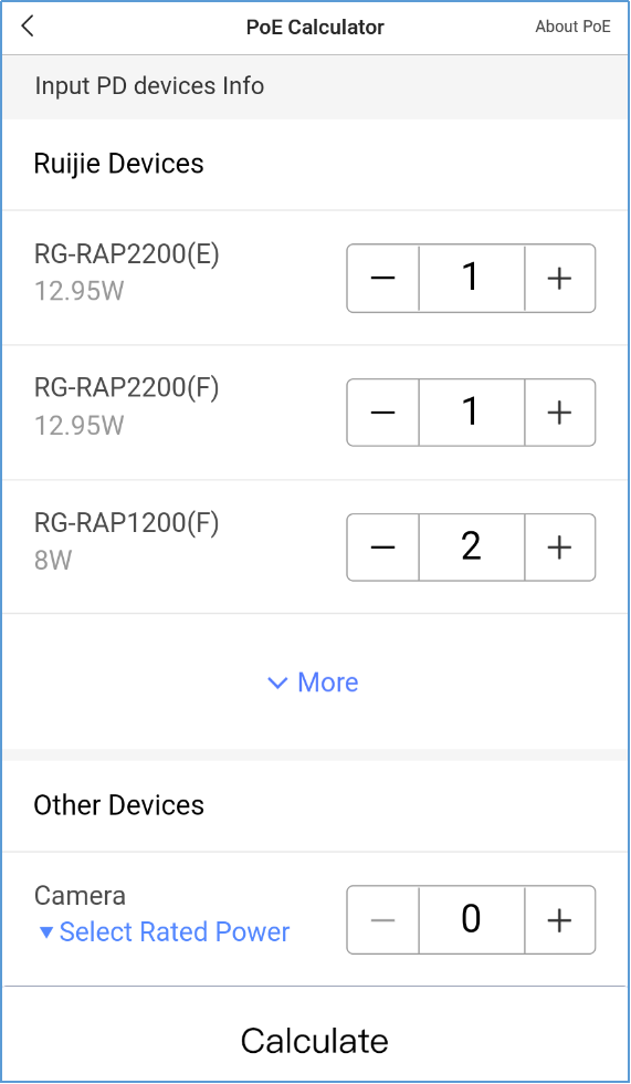

Step2: Input PD device Info.
For Ruijie/Reyee Devices: Select devices model and quantity

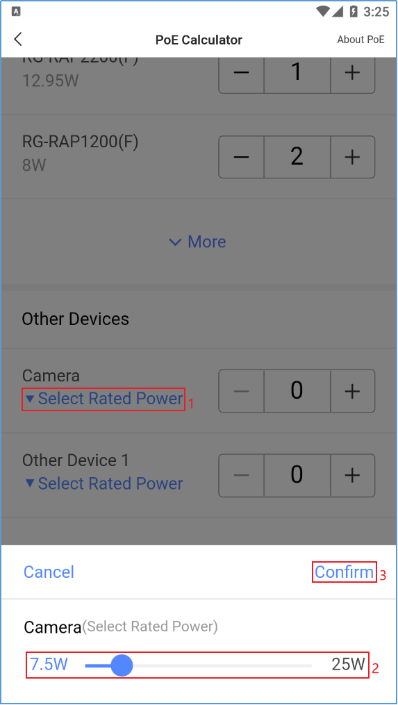

For Other devices: Click "Select Rated Power" to select the power of the device and then set the quantity

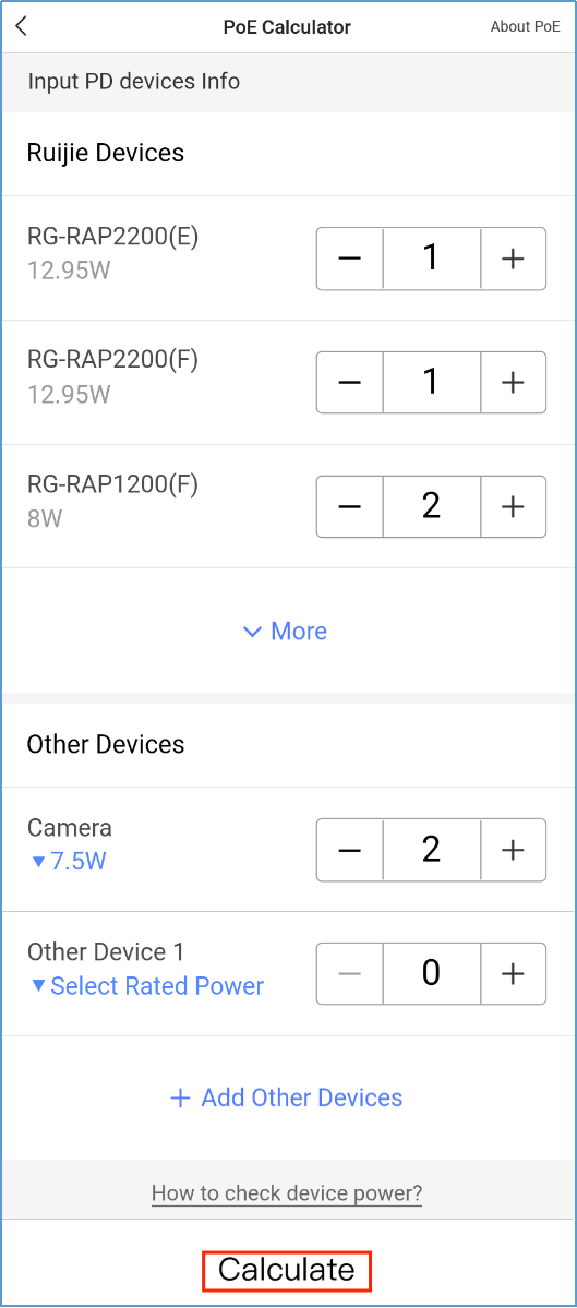

Step3: After completing and confirming the information of the PD devices, click the “Calculate” button to start the calculation

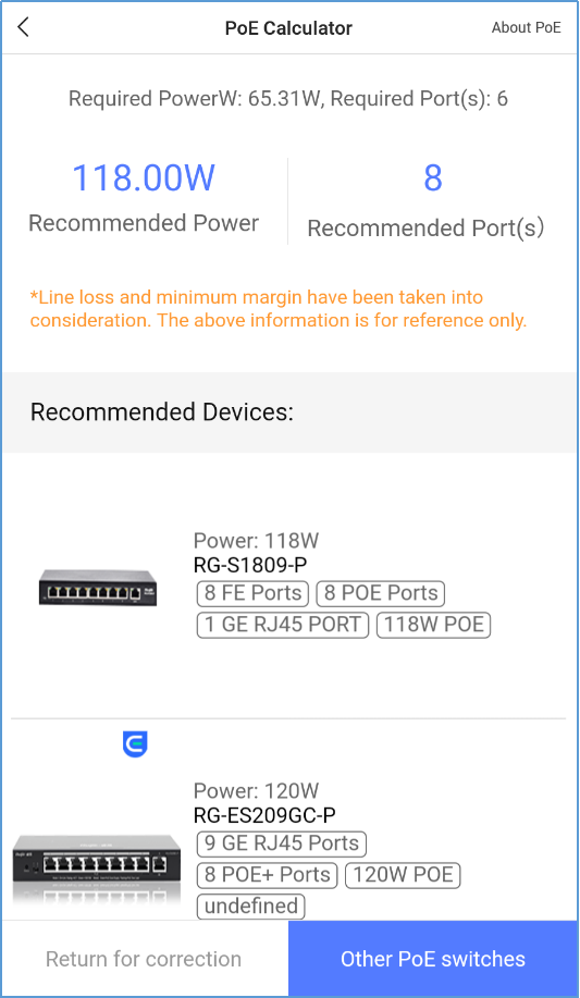

Step4: Select the switch based on the calculation results.
