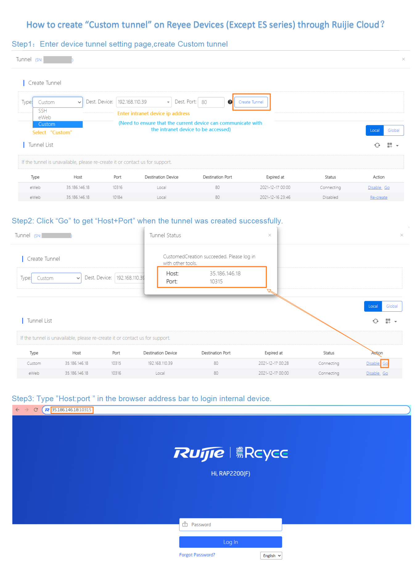

Do you know Reyee devices (Except ES series) support create "Custom tunnel" through Ruijie Cloud?
This let  you can access
intranet
  devices through devices that are online on the cloud.
Notice:
Need to ensure that the current device can communicate with the intranet device to be accessed

On Device Details page of the device which does not support the tunnel function, you can choose a Remote Host who support tunnel feature in the same project to help creating tunnel for other devices that don’t support creating tunnels, if devices can communicate with each other.
