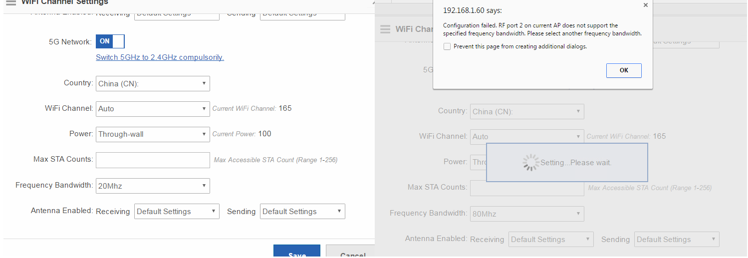

Problem description:
Web display error when AP adjust the frequency bandwidth on the web, suggesting that AP does not support the configuration.
Cause of issue:
Through the Figure 1 can be found in the AP is using the 165 channel, which is the end of the channel, the need to adjust the AP channel to 149 or 151 can use a larger frequency bandwidth.
Figure 1
Figure 1
