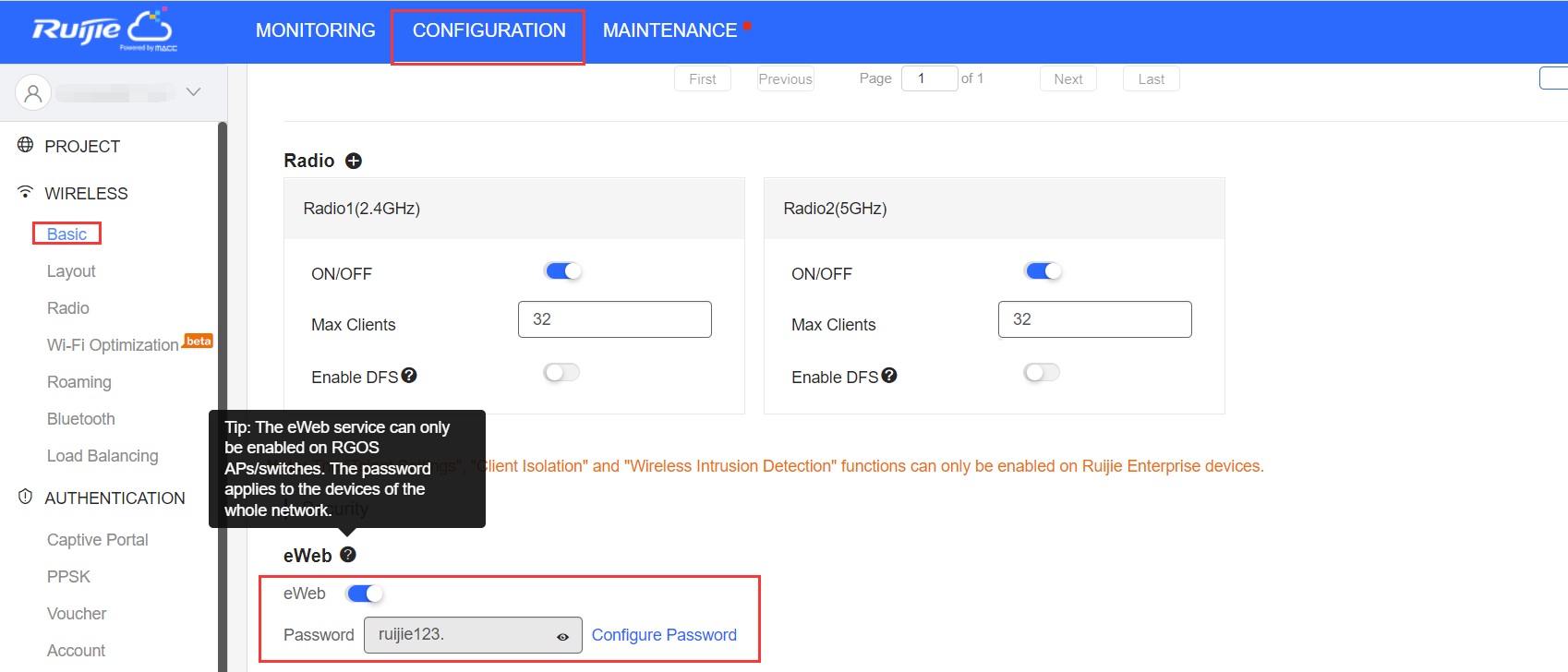

How to do if i forget the password of reyee gateway? Reply
GTAC-Wayne
Level 2
5302 0 2022-4-26 09:27:12
If the device is online on Cloud, the eWeb password of this devices of the whole network can be seen in the Cloud, shown as the below picture.
If the device is not online on Cloud, you can try reset this device then use the 'admin' as the eWeb password to login it.
