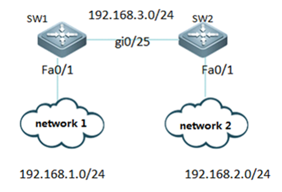

Configure the switch with static routes and ensure that users in network 1 can communicate with users in network 2
b) Network Topology
c) Configuration Tips
1) Assign IP addresses to SW1 and SW2
2) Configure Static Routes on SW1
3) Configure Static Routes on SW2
4) Save Configuration

3) Configure Static Routes on SW1
Ruijie(config)#ip route 192.168.2.0 255.255.255.0 192.168.3.2  //configure static routes to destination subnet 192.168.2.0/24 and next hop is 192.168.3.2
Note:
1) When you configure static routes, there're two ways to specify next hop. You can specify an IP address ,or you can specify a local outgoing interface.
2) We suggest you to use IP address as next hop
4) Configure Static Routes on SW2
Ruijie(config)#ip route 192.168.1.0 255.255.255.0 192.168.3.1  //configure static routes to destination subnet 192.168.1.0/24 and next hop is 192.168.3.1
