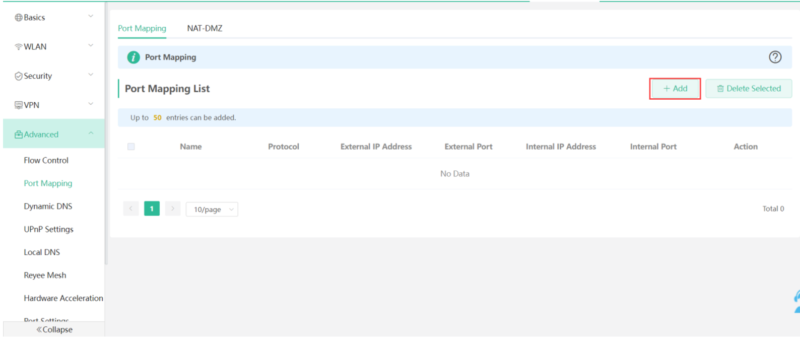

Choose More > Advanced > Port Mapping.

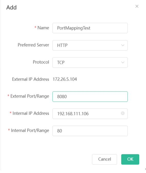

Click Add. In the pop-up dialog box, enterthe name, service type, protocol type, external port/range, internal IPaddress, and internal port/range. A maximum of 50 port mapping rules can beconfigured.
Name: Enter a name for easy maintenance.
Preferred Server: Select a service to bemapped, such as HTTP or FTP. The device will automatically fill in the internalport number of the service. If you are not sure of the service, you can selectCustom.
Protocol: Select the transport-layerprotocol used by the selected service, such as ALL, TCP, or UDP. Theconfiguration on the server end must be consistent with that on the client end.
External Port/Range: Enter the portnumber used for external network access. You need to check the port number insoftware, such as camera monitoring software.
Internal IP Address: Enter the LAN IPaddress used by external networks to access the device, such as the IP addressof an IP camera.
Internal Port/Range: Enter the portnumber used by an application accessed by external networks, such as port 8080used by the Web service.
