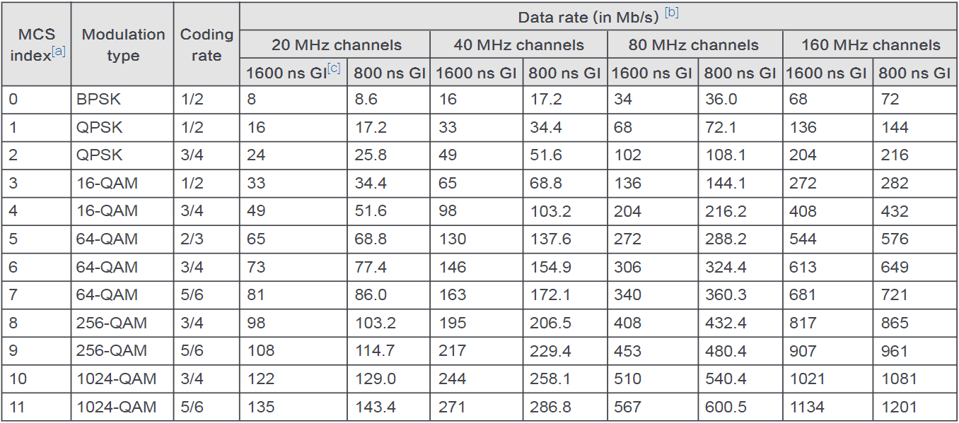

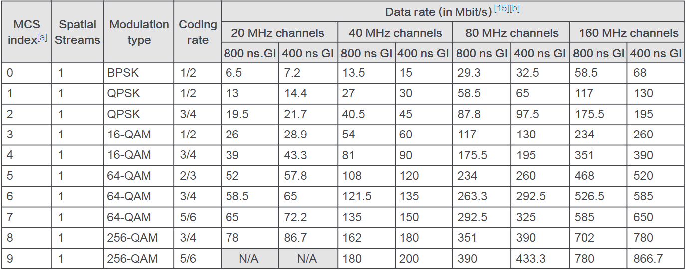

Rates in 802.11ax and 802.11ac under 1x1 spatial flow (MCS rates for 802.11ac and 802.11ax) Reply
GTAC-Henry
5535 4 2022-5-5 09:46:04
802.11ax
802.11ac
