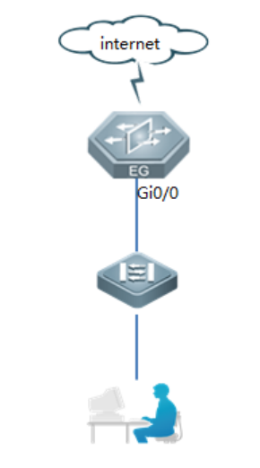

1. LAN users access the Internet through the EG device.
2. The WAN bandwidth is 10 Mbps, the address of the WAN port is 192.168.33.56/24, the address of the WAN gateway is 192.168.33.1, and the addresses of LAN ports are in the 192.168.1.1/24 network segment.

Network Topology

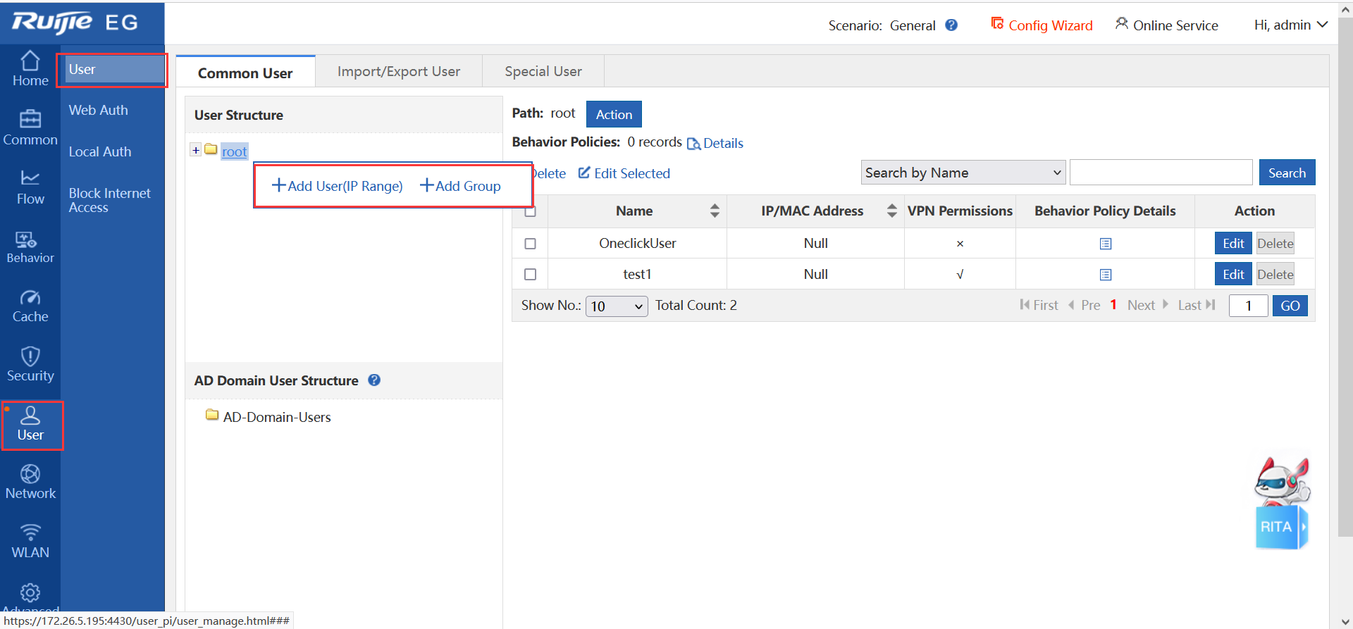

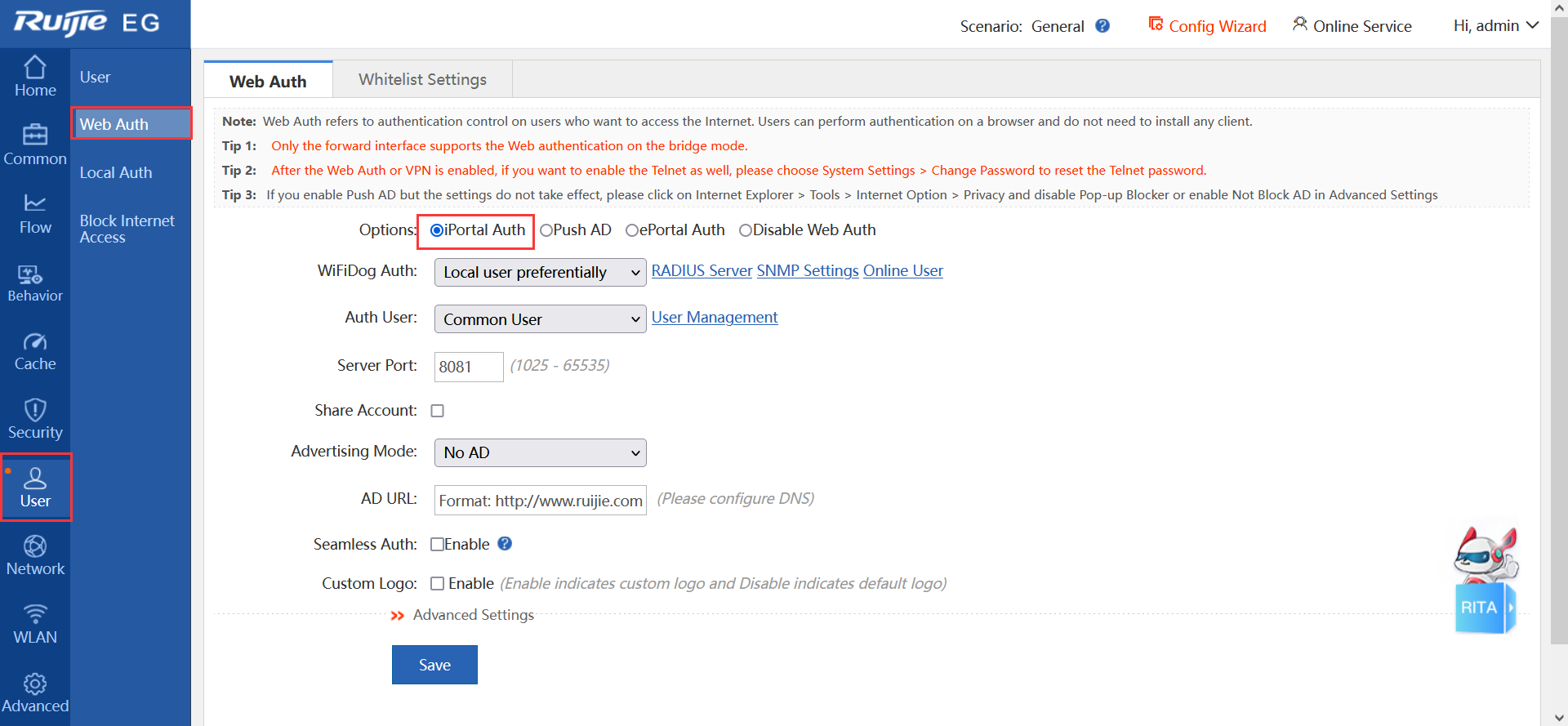

Choose User> Auth and click Internal Portal Auth on the Web Auth tab page to enable the internal authentication function, as shown in the figure below.
a. Internal Portal Auth: Refers to the internal authentication server of the EG device.
b. Auth Mode: A users needs to be authenticated before accessing the Internet. Specify the server matching priority for authentication information here.
c. Advertising Mode: Ruijie EG device provides the advertisement push function, for example, a hotel can use this function to push the hotel homepage to guests and promote the hotel brand. You can also set the mode to No AD, Display AD Before Auth, or Display AD After Auth.

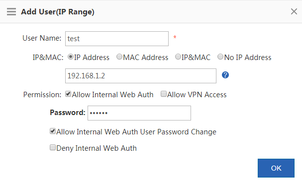

Add a user to be authenticated: Click a user group in the user organization structure on the left, add a user (IP range) to the user group, and configure the username and password, as shown in the figure below.

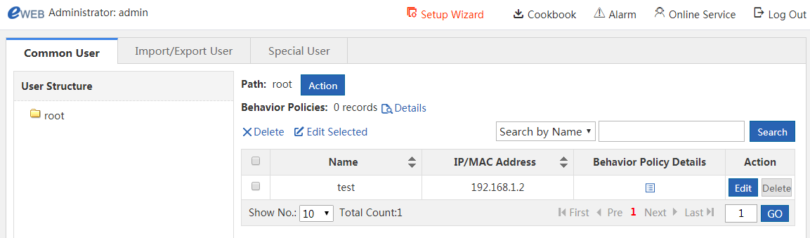

A user added successfully is displayed in the user list, as shown in the figure below.

If you select Allow Internal Web Auth User Password Change when configuring a username and password. The Change Password option is displayed after Web authentication is successful.

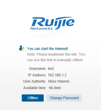

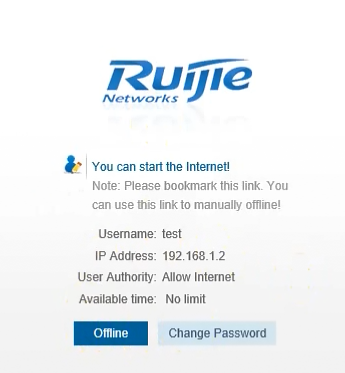

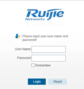

After the configuration is complete, the authentication page is displayed when a user browses a Web page for the first time.
Enter the correct username and password and click Login. The authentication success page is displayed.
