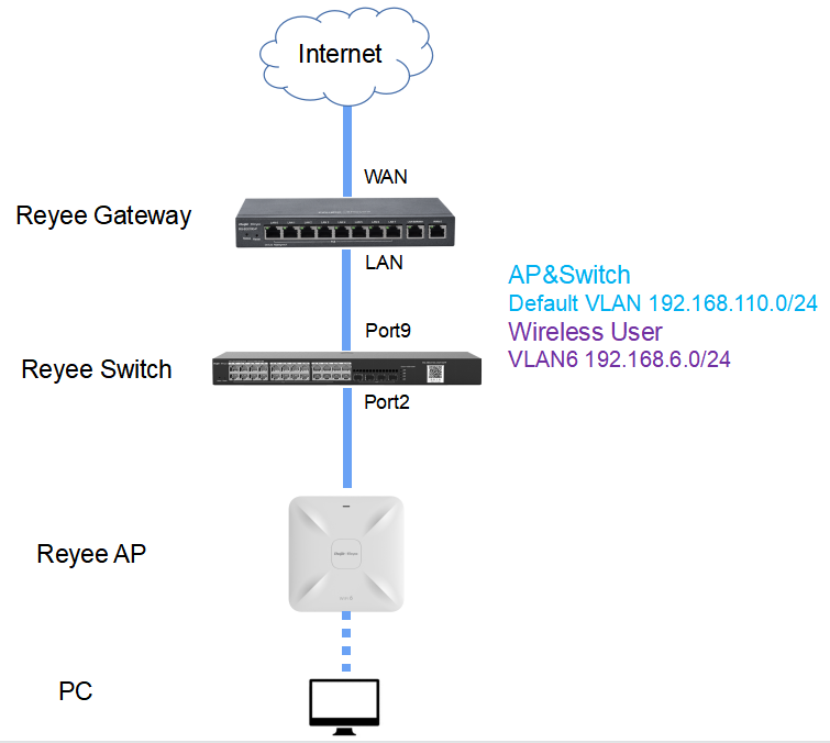

Requirement
● EG works as a DHCP server to assign IP addresses to wireless users and AP & switch devices
● The AP & switch devices obtain the IP address 192.168.110.0/24 in default VLAN network segment for Internet access
● The wireless users obtain the IP address 192.168.6.0/24 in the VLAN6 network segment for Internet access
Network Topology

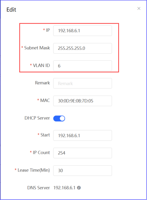

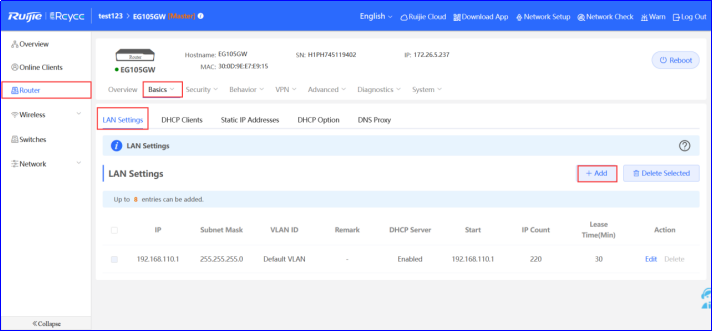

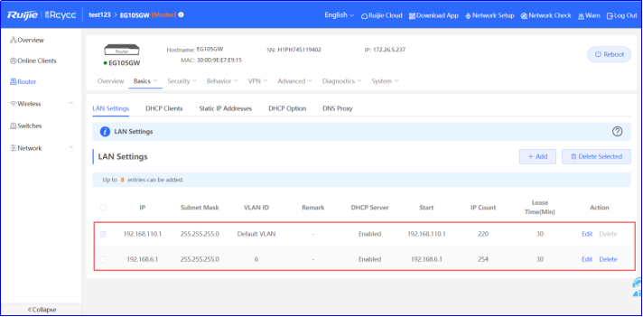

Step 1: Click
Router
-> Basics-> LAN-> LAN Settings-> Add

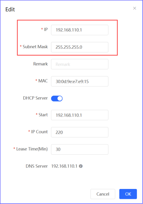

, Configure LAN Settings and DHCP pool of VLAN1 and VLAN6 network segment on the EG.

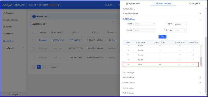

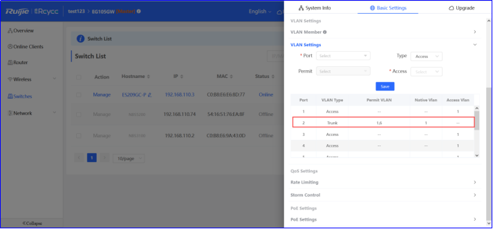

Step 2: Click

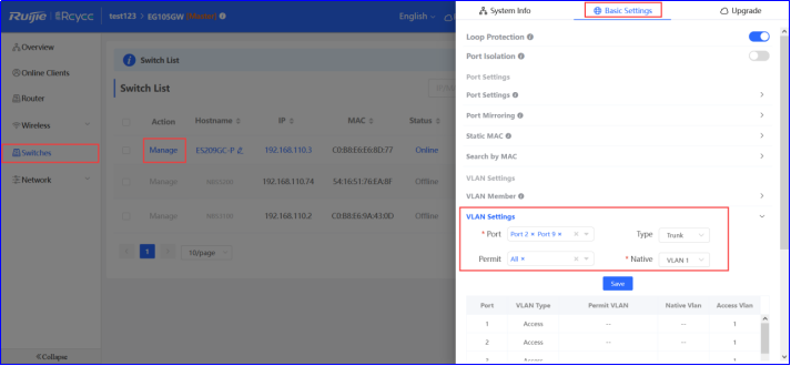

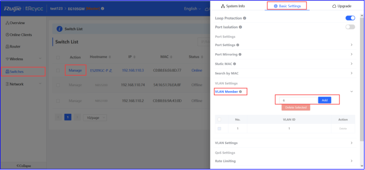

Switches-> Manage-> Basic Settings-> VLAN Member to create VLAN6 on the switch, and clickVLAN Settings to set port2 and port9 which connect to AP and EG to trunk port and allow the VLAN1 and VLAN6 to pass through, then check the port settings on the device.

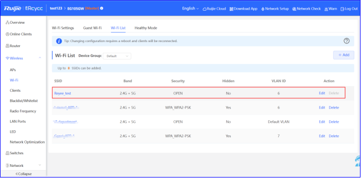

Step 3: Click

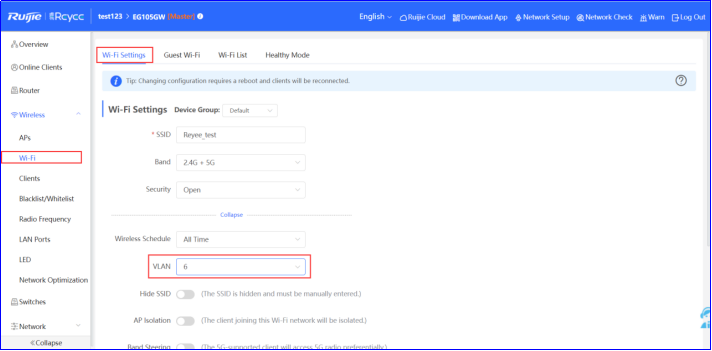

Wireless-> Wi-Fi-> Wi-Fi Settings, Configure SSID named Reyee_test and set VLAN6 to this ssid.
