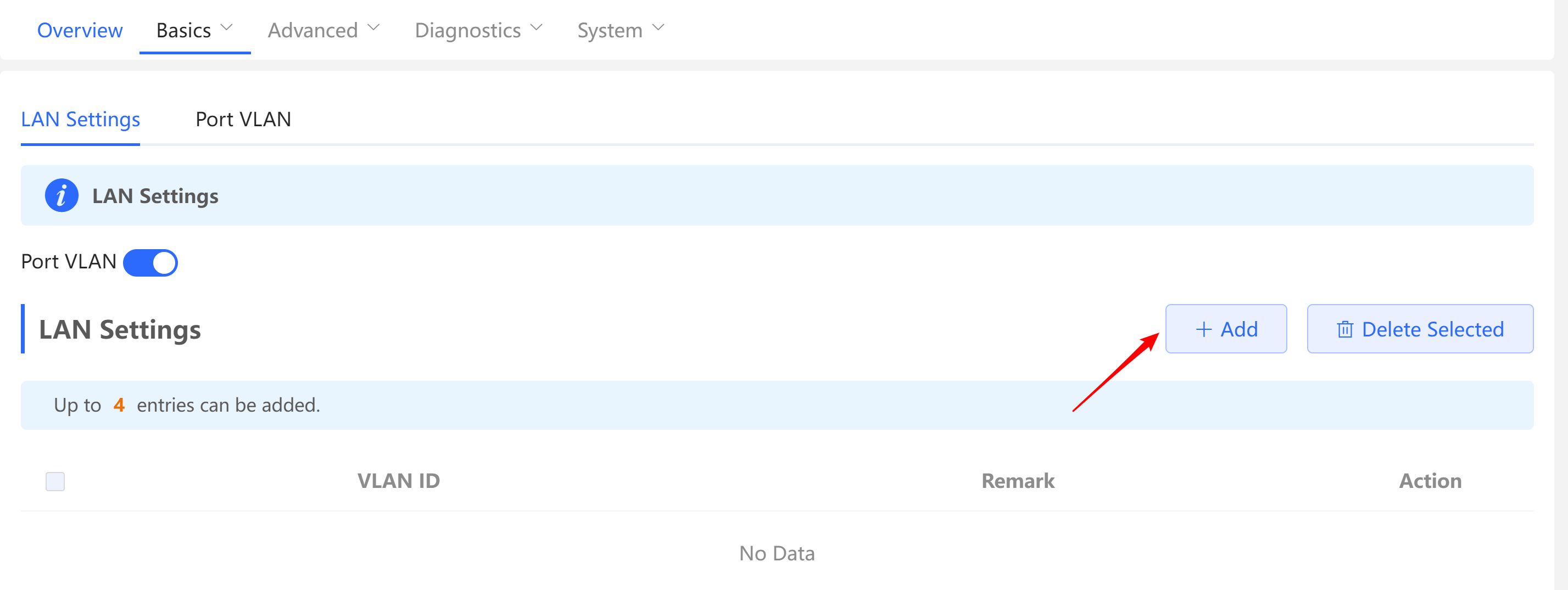

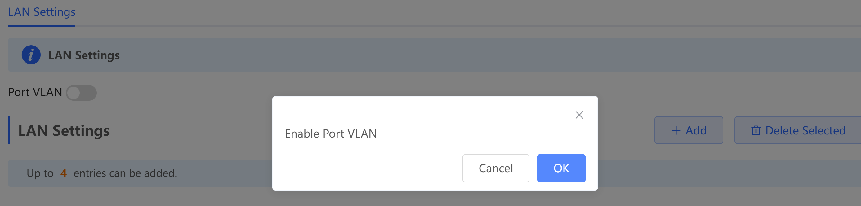

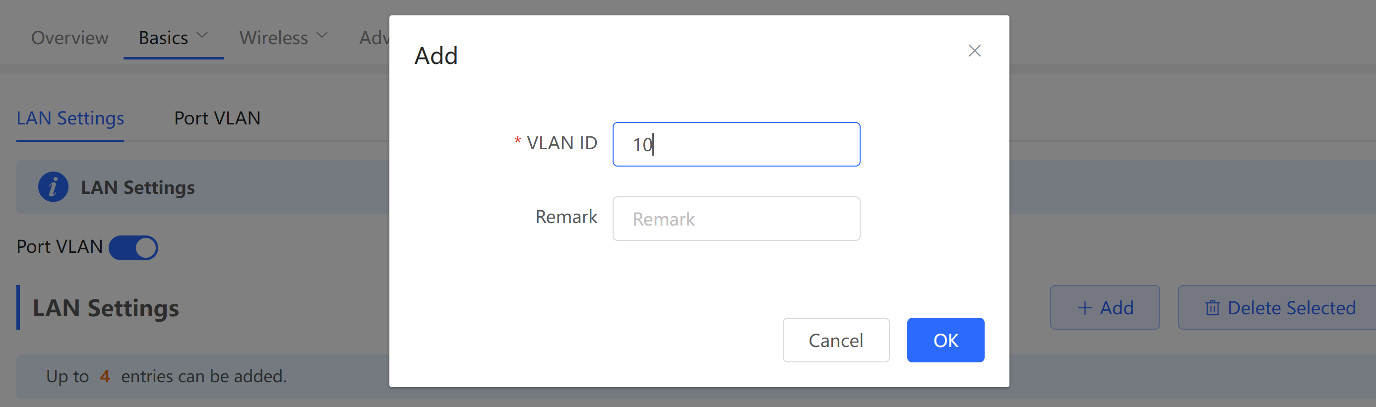

a) Log in to the web interface of RAP, select Basic-LAN, then enable Port VLAN  add vlan, such as adding vlan10

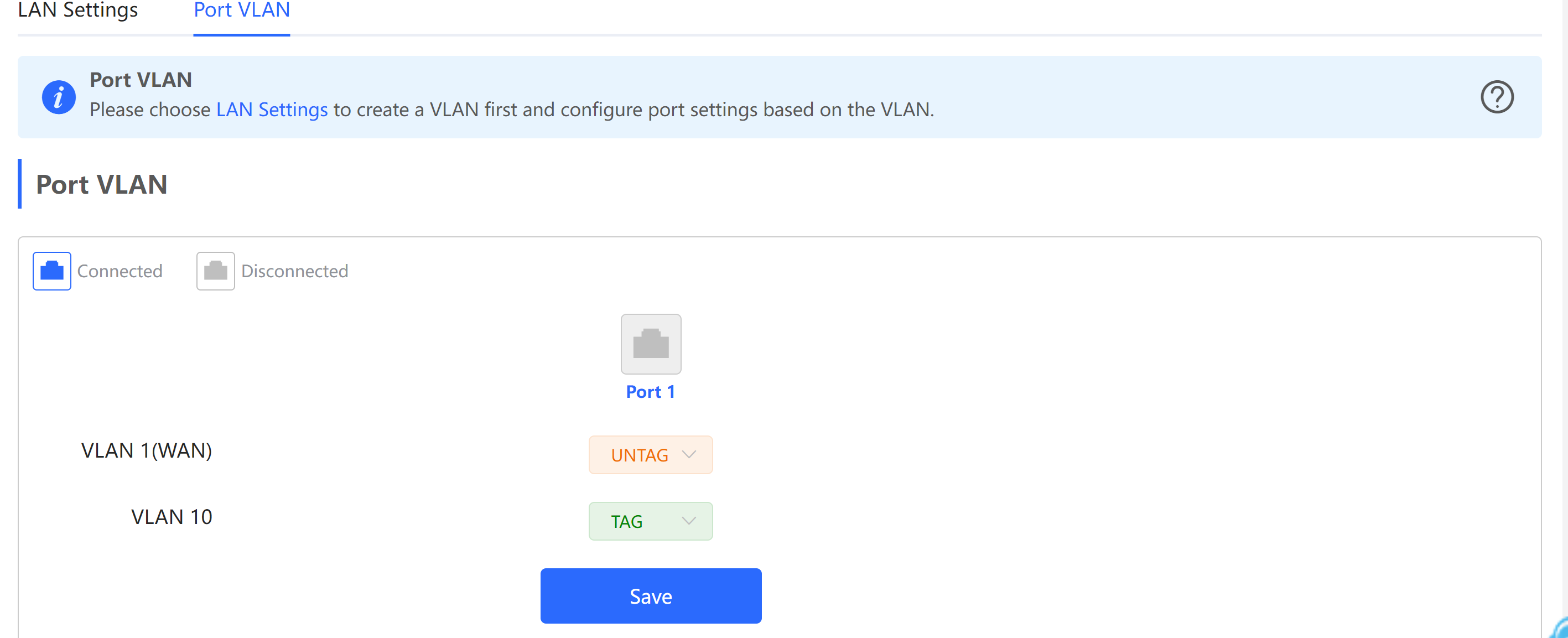

b) click Port VLAN, configure according to your needs
notcie:
UNTAG: If VLAN 10 is set to untag VLAN,VLAN 10 will be the native VLAN of this port. The packets from VLAN 10 will be forwarded over this port without tag VLAN 10 and all untagged packets over this port will be taken as the packets from VLAN 10.
TAG:
If VLAN 10 is set to tag VLAN, the packets from VLAN 10 will be forwarded over this port with the corresponding VLAN tag.
Not Join:
If VLAN 10 is set to Not Join , this port will not receive or transmit packets from VLAN 10.
