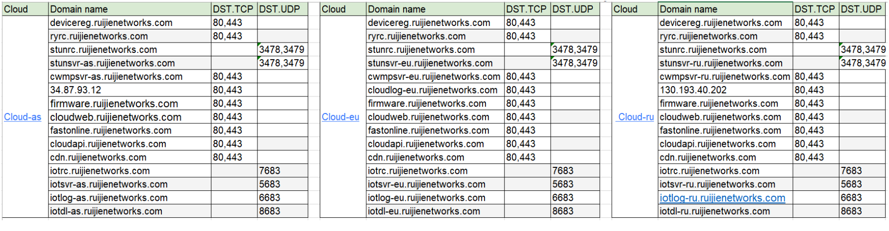

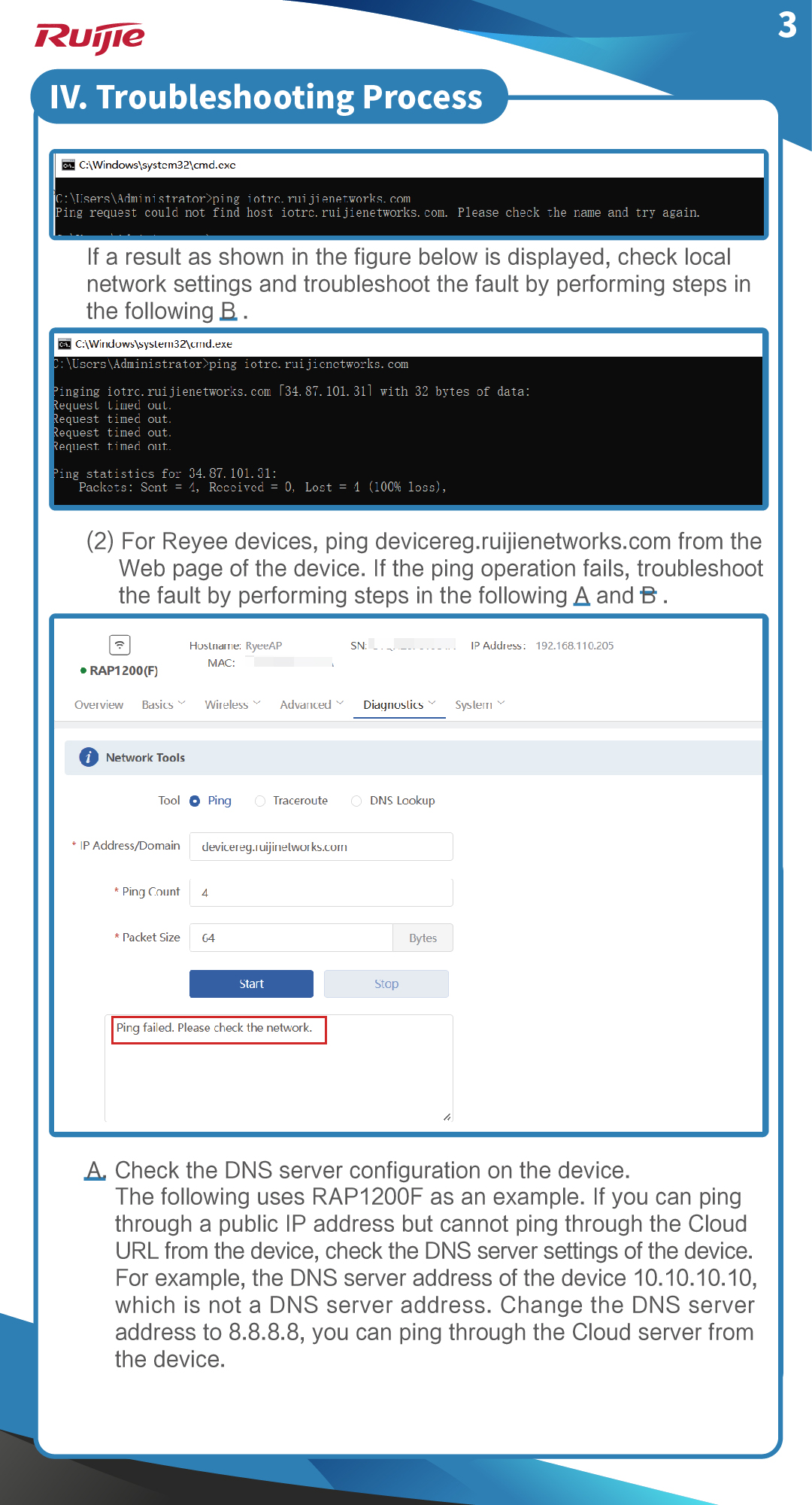

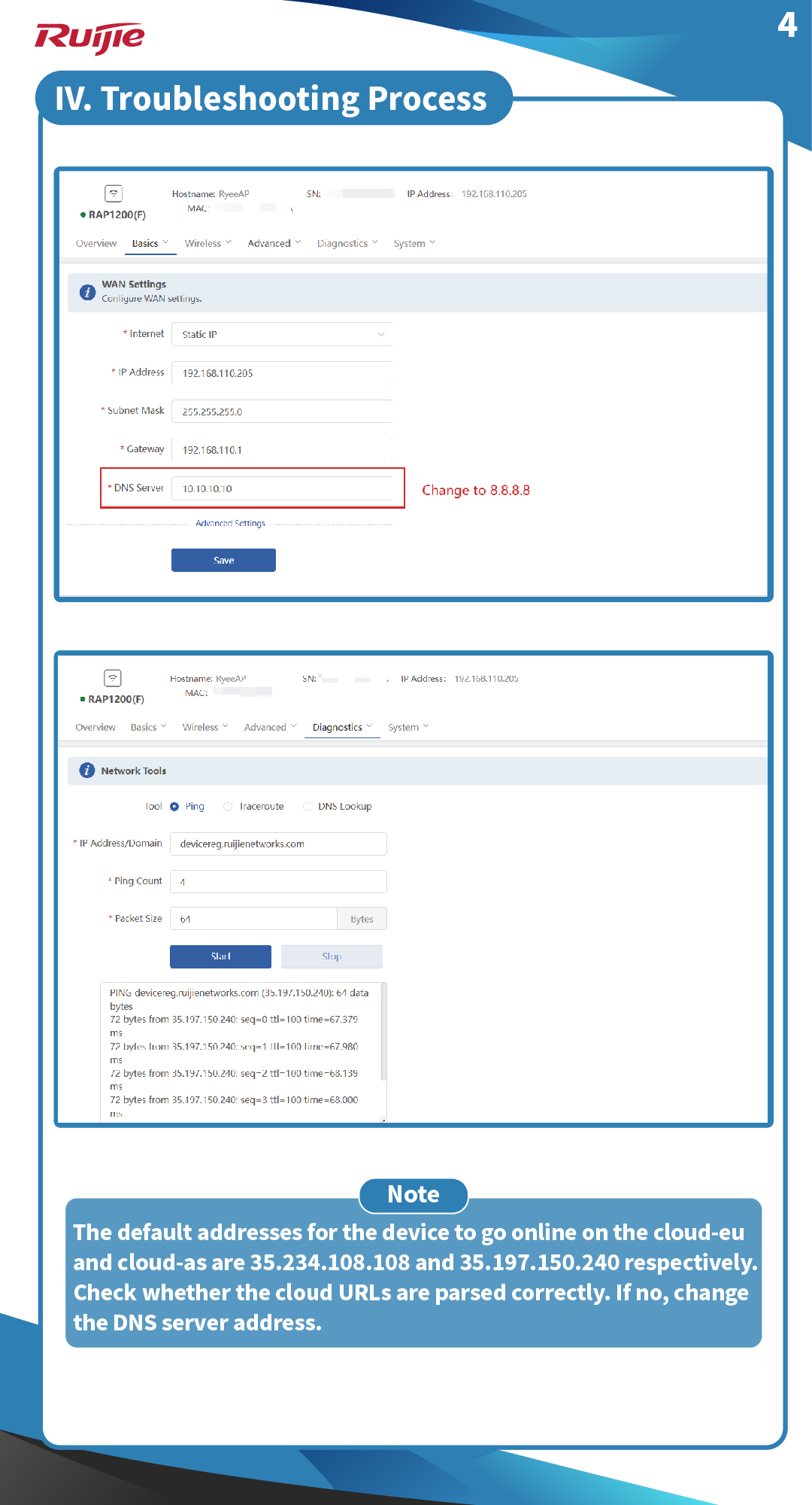

I had that issue, we have a DNS server on-site, this is assigned on the DHCP as primary DNS, so the device was unable to communicate with cloud, after we changed the DNS on the reyee device, it worked
0 2022-6-7 09:25:20 View all replies
Aldo Ramirez replied at 2022-6-7 09:07
I had that issue, we have a DNS server on-site, this is assigned on the DHCP as primary DNS, so the  ...
If there are a on-site DNS server, try to add these domian with the common IP address to the DNS server, then it will work.
0 2022-6-7 09:32:00 View all replies
GTAC-Henry replied at 2022-6-7 09:25
If there are a on-site DNS server, try to add these domian with the common IP address to the DNS ...
Thanks a lot for the reply buddy!
