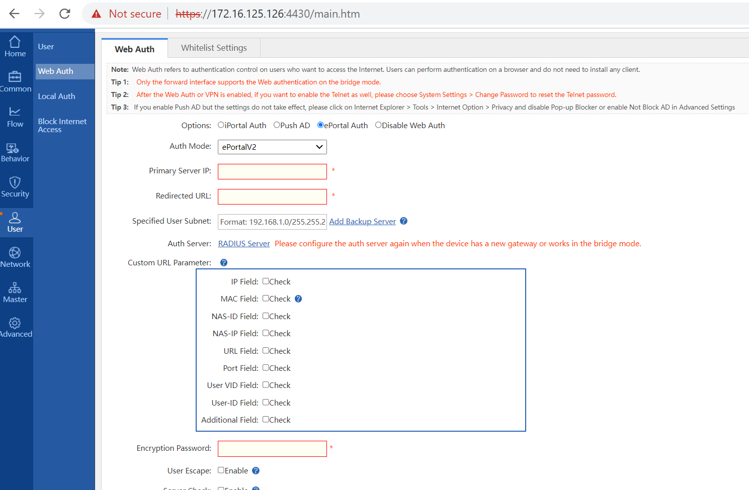

Hello,
I need help to configure the ePortal in the EG3230 gateway. What parameters I need to put here ?

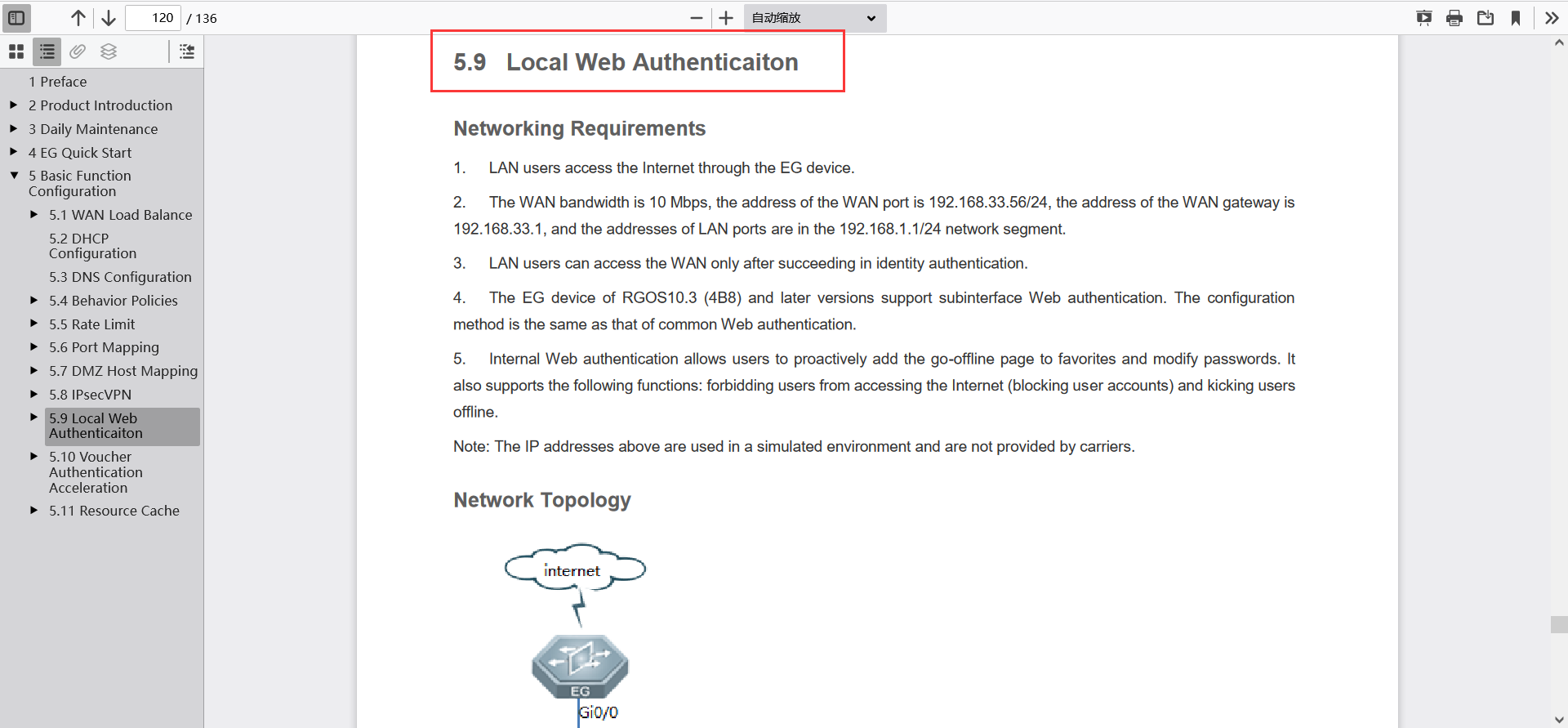

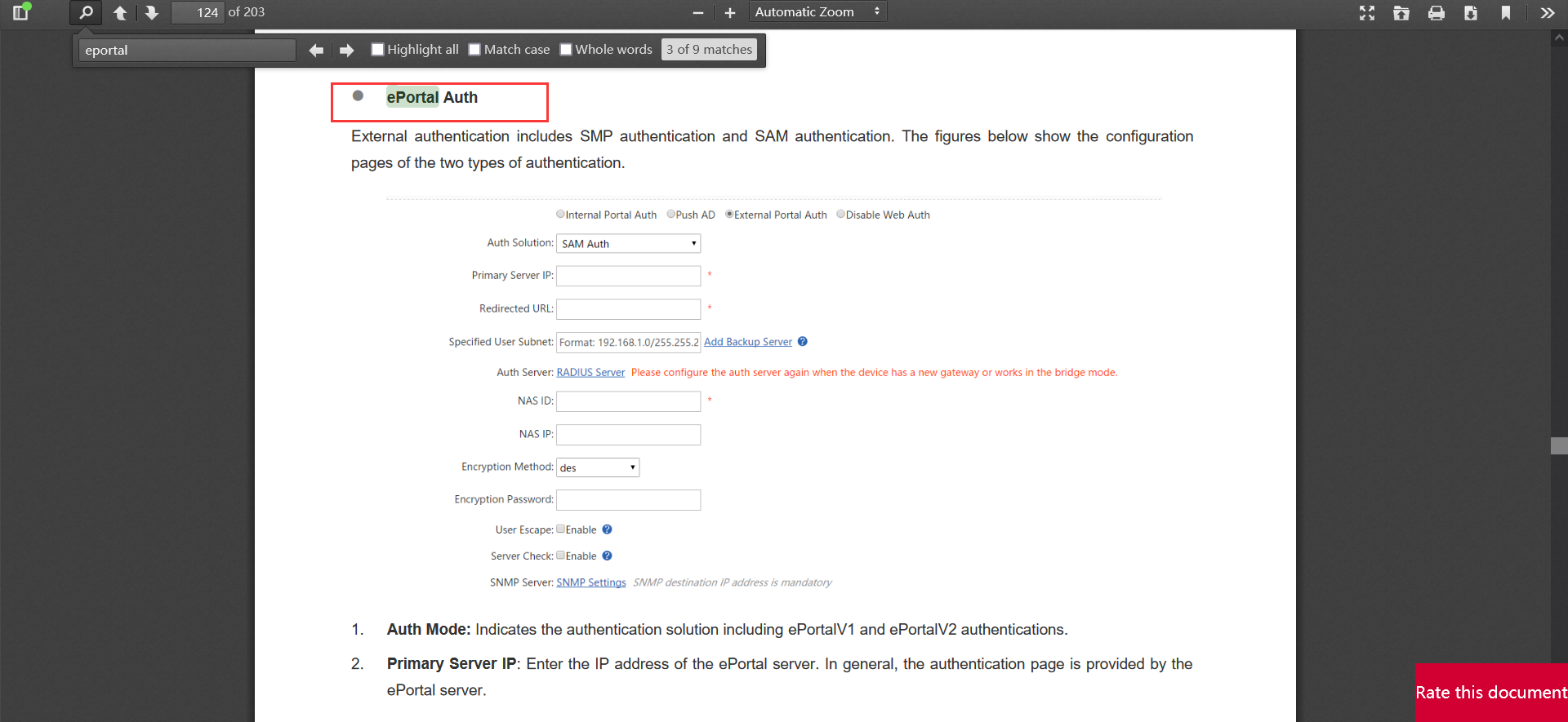

Please try to follow this guide on page 124:
https://www.ruijienetworks.com/resources/preview/76379

Thank you.
But I already checked this document.
My question is, if I want to enable Ruijie captive portal redirection (to Ruijie Cloud) in gateway level instead of the AP level, what parameters I need to use ?
My target is to disable captive portal in APs & keep it enabled in the gateway.
I don't want to use Local-Auth, I want to use Web-Auth.
Is it possible ?

Dear sir,
According to your requirements, you can configure local authentication can use auth integration with cloud on Ruijie EG, hope this guide can help you:
http://cloud-as.ruijienetworks.com/wiki/c/User_Guide__Configuration__Authentication5
First configure captive portal on cloud then apply the portal to EG.
Jenny

If you need two different templates for 2 SSIDs, you can one use local auth, another one use cloud auth.
Here is the guide about how to configure local auth on ruijie EG:
https://files.ruijienetworks.com/03effa47-4e9c-41a4-9f9c-b20abdf8c8e8/Ruijie%20RG-EG%20Implementation%20Cookbook%20(V1.0).pdf?_upd=true&_upt=0a275cdd1652949962
