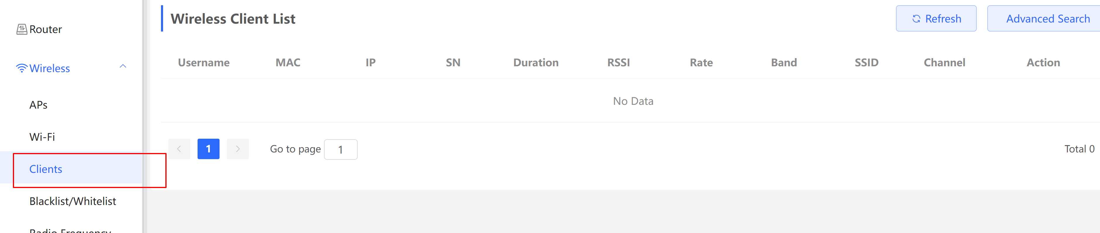

For reyee AP, you can view it through the web interface:
