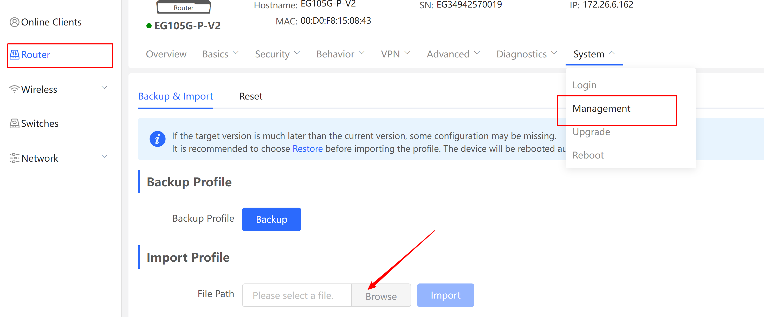

  • For Ruijie devices, such as EG, AC, AP, and Switch, you can export the device's CLI configuration file
  • For Reyee device, you can back up the configuration file on the device's local web or Cloud, and then import the configuration file on the web side.
(Note:If the target version is much later than the current version, some configuration may be missed. It is recommended to choose Restore before importing the profile)
