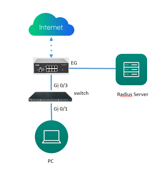

Problem Description:
Authentication process doesn't  start on the suppliant side after plugging it under the dot1x port of switch.
Topology

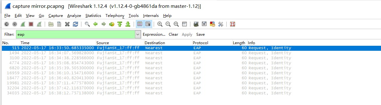

    2. Capture packet on supplicant side, if it can receive the packet from switch but no send any eap response packet.
Please modify the setting of supplicant side refer to the following guide:
https://www.binghamton.edu/its/about/organization/operations-and-infrastructure/networking/windows-manual-config.html
