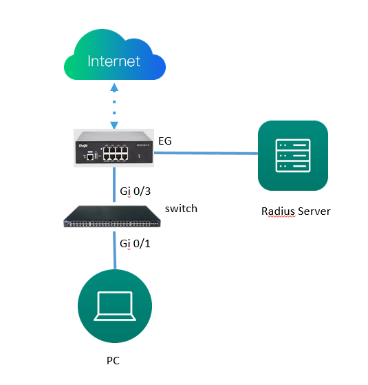

Problem Description:
Authentication process doesn't  start on the suppliant side after plugging it under the dot1x port of switch.
Topology
Solution
  • Checking the configuration of the switch by referring to the following guide.
How to configure 802.1x authentication on Ruijie Switch - Switch -  ruijienetworks
    2. Capture packet on supplicant side, if it can receive the packet from switch but no send any eap response packet.
Please modify the setting of supplicant side refer to the following guide.
https://www.binghamton.edu/its/about/organization/operations-and-infrastructure/networking/windows-manual-config.html
