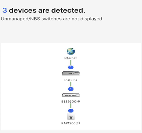

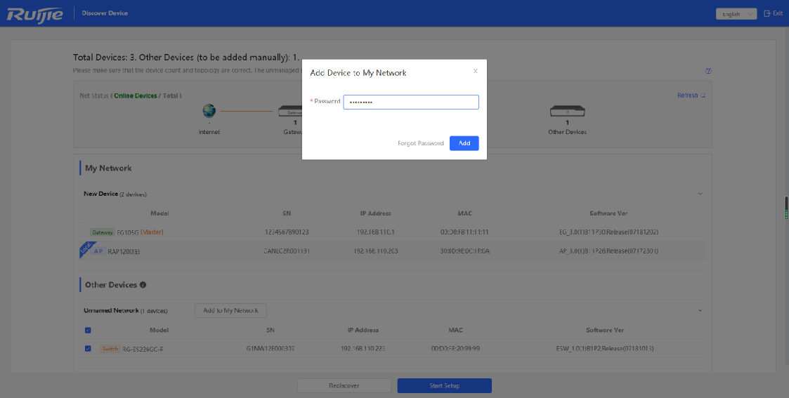

  • Check whether the devices are connected with same network and merge all the devices to the same network. Try to detect the device and add it to the network(with the device's password)

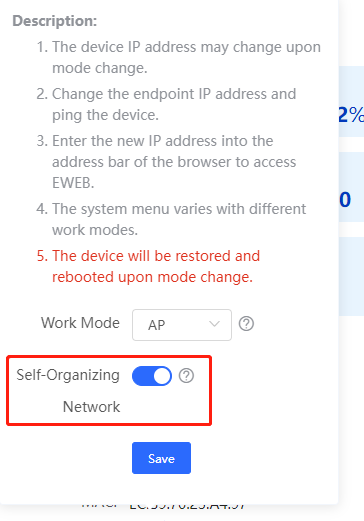

  • Check whether the SON is disable. Access to the device's eweb to enable the SON.
