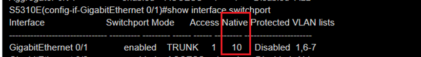

1.Cli configuration for  native vlan on switch port
For example, set vlan10 to the native vlan
Ruijie(config)#int g0/1
Ruijie(config-if-GigabitEthernet 0/1)#switchportmode trunk
Ruijie(config-if-GigabitEthernet 0/1)#switchporttrunk native vlan 10
Check configuration.

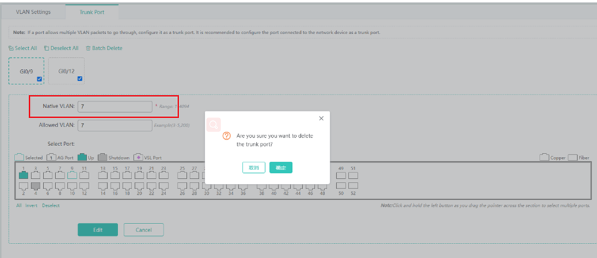

2.Web configuration for  native vlan on switch port
For example, set vlan 7 to the native vlan.
Select a port, specify Native VLAN and Allowed VLAN, and click Save. The "Configuration succeeded." message is displayed. In this case, the newly added trunk port is displayed in the trunk port list.

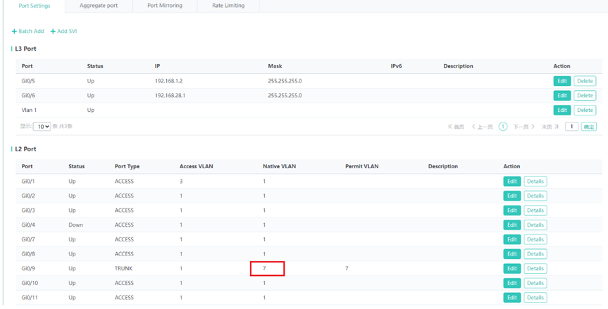

Check configuration
